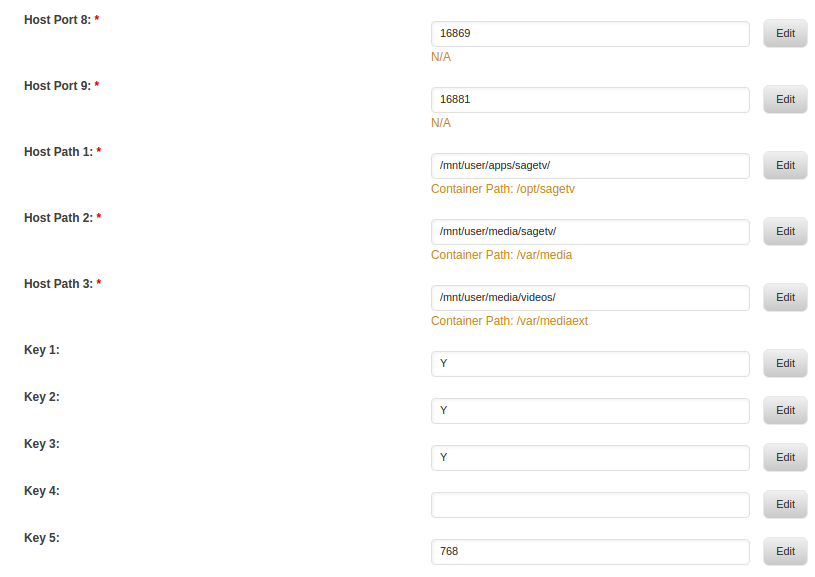

After upgrading to RC1, when I go to install a Docker container using a template that I have not used before, all the VARIABLE sections are missing the actual variable names?
Is this by design??
I've attached 2 images... one if from the RC1 and shows no variable names, just the default value... and the other shows what it used to look like.
When I edit existing docker configs I see the correct layout... so this is ONLY happening when I'm installing something new that has never been installed.
Not the behavior I'm seeing which container are you adding?
I see it specifically when I add deluge-vpn, sagetv-server-java-8, and any pretty much anything that  I add when I add it from the "Apps" tab.  But as i said, If I edit an existing container, or try to add from the my templates section.. it shows up correctly.
I also installed the CA plugin, so I just have stock unRAID.    If I manually add my template repo
https://github.com/stuckless/sagetv-dockers/tree/master/unRAID/stuckless-sagetv
And select something from there... I don't get any variable names... just default values...
I have 2 machines that are running unRAID Basic, and I updated both today to the RC1, and this is the behaviour that I'm seeing on both :(
I guess I need to see if there is a way I can downgrade to another version and wait for RC2.
EDIT:  I downloaded to beta-23 and I get the proper display for the docker configuration.  Odd that no-one else experienced this but I experienced it on 2 difference machines :(
I am seeing the same thing, except it happens with all of my existing dockers too -- for instance, on the main edit screen it shows:
  Key 1: 99
  Key 2: 100
But I have to hit the edit button to find out that Key 1 is "PUID" and key 2 is "PGID".  I didn't grab a new screenshot because they look just like the ones stuckless already provided here:

Here are the relevant portions of one of my user template xml files, in case something obvious is wrong:
<Environment>
  <Variable>
    <Value>99</Value>
    <Name>PUID</Name>
    <Mode/>
  </Variable>
  <Variable>
    <Value>100</Value>
    <Name>PGID</Name>
    <Mode/>
  </Variable>
</Environment>
<Config Name="Key 1" Target="PUID" Default="99" Mode="" Description="" Type="Variable" Display="always" Required="false" Mask="false">99</Config>
<Config Name="Key 2" Target="PGID" Default="100" Mode="" Description="" Type="Variable" Display="always" Required="false" Mask="false">100</Config>

Ah, so the issue is that the Description is empty.  Was something supposed to update the description to something like:
<Config Name="Key 1" Target="PUID" Default="99" Mode="" Description="Environment Variable: PUID" ...

What's going on here is that it is indeed a bug in 6.2RC1.
Previously dockerMan would take the name of the variable that was listed on a v1 template (99.9%) of the ones present and then move it over to the v2 section (only present within CA on 0.1%) of apps.  And then display the v2 section.  Now its not doing that.
Just another item on my list of why I believe that moving to v2 was a mistake.
Is the v2 template stuff documented somewhere?  When i was creating my templates, I ended up just finding existing unRAID templates and figuring it out from there... it would be nice if the unRAID web ui provided a quick link to the docker template structure.  Is the v2 templates a CA thing or an unRAID thing?
It is documented here: http://lime-technology.com/wiki/index.php/DockerTemplateSchema  However the absolute best and easiest way to create the xml file is to just add a container via the docker tab, fill out the the appropriate entries, then hit save (turn on authoring mode within docker settings) (followed by a copy/paste - never delete anything from this resulting template)  Any way else is going to give you a world of trouble.
The only time you need to manually edit the resulting xml is to handle the tags listed here:  http://lime-technology.com/forum/index.php?topic=40299.0
And it is an unRaid thing, and one which I have been vocal about it being a mistake in moving to rather than merely expanding the v1 specification.
Is this by design??
This is a bug and will be fixed in the next release.
