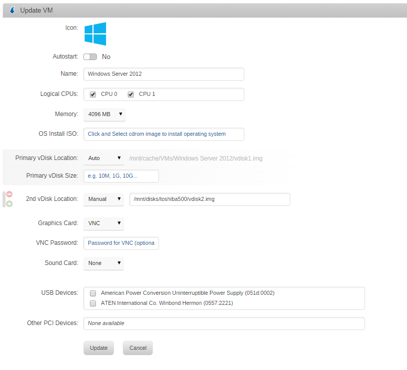

I'm finally playing with VMs and I'm doing it on 6.2.0rc1, so don't know if this is normal or not, whenever I edit the VM the vdisk1 location is lost (changes to auto) and before clicking update I always have to reset vdisk1 to manual and indicate path or get the error below, vdisk2 config is not lot, is this normal?

I had that problem when in settings, vm manager the Default VM storage path was not set correctly. (you will need to toggle advanced view to see that option). I should check what it is set to.  I had to do this when upgrading from 6.19 to 6.2
