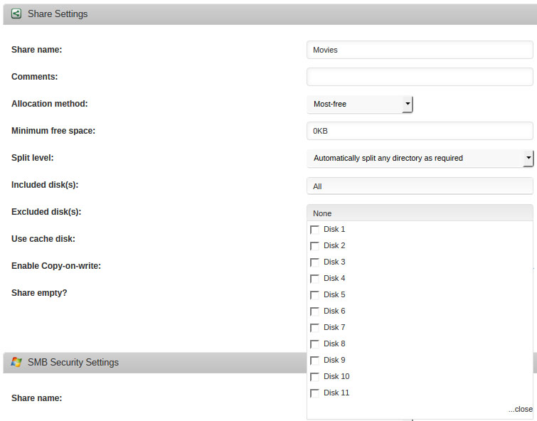

I've got a drive that's failing (drive 1), and it's going to be a short while before I am able to replace it.  Fortunately, I have plenty of spare space on the rest of the array such that I can use Midnight Commander to move everything off it.  Is there something I can set that stops new files being written to drive 1?  I don't want to lose the "drive 1" slot if possible...?
Yes - on every Share you have, exclude Disk 1 - done  ;)
Dawwww, of course, thanks :)  I was hoping there'd be a higher level way.
Once I'd cleared all the data off the drive, I ended up doing a new config and not assigning anything to disk 1.  I still have about 5TB of space, so I can live with 1 less drive for a while.
The drive is still in the box, just unassigned, and I'll order a replacement soon (well, an upsized parity).  Because my server is under the stairs and the case doesn't have any hot swap bays, it's a back-breaking hassle to get it out, so I'll do it all in one hit.  Thinking of moving up to the 8TB Archives - could seriously downsize over time then.
