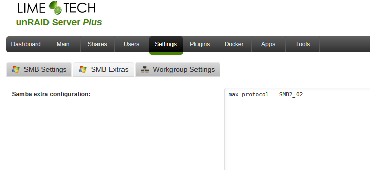

quick update - I tried this in smb extra settings (see attached screenshot). No luck - still not seeing Unraid in windows 10 network.  I rebooted both the unraid server and windows 10 PC after applying the new setting.
any ideas?
thanks

hate to dredge the windows 10 SMB issue back up again but  I still can't get it to work (unraid not visible in windows 10 network).
in addition to trying the fix mentioned here (adding max protocol = SMB2_02 into my smb conf) I also tried
--changing server name to all caps (a post on microsoft tech support site around case sensitive issues) - did not work
--a suggestion to make something like the router the master browser, and disable it on unraid.  Trying that now but so far no luck getting the asus  RT-68 to be master browser
any other ideas welcome.  I guess most do not have this issue or have just learned to live with it.
thanks
thanks
Install Dynamix Local Master plugin. It will tell you which computer on your network is the master. Then you can shut that master down until something else takes over, such as your router or unRAID.

Thanks.  I do have it installed and it has always said unraid is the master. (Btw the notification of this status in top right does not seem to be there anymore in RC2?)
For the asus looks like I might have to install 3rd party firmware for this feature
