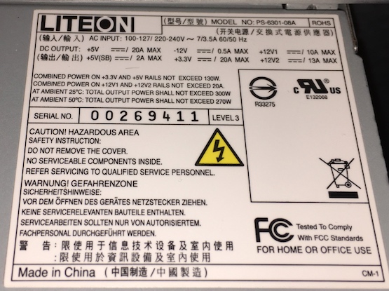

I was starting to wonder about the power supply. Its an old old Lite On rated for 270 watts. The fan pumps luke warm air out of the power supply during normal operation with all disks spun down, but during large file transfers or parity checks it pumps out hot air (my cx430 in my other server never has hot air coming out of it). FYI, I am running 4 x 7200 rpm HDD, 1 x SanDisk SSD Cache, and 2 x92mm fans all on a SuperMicro X8SIL-B Mobo. Also, if it makes a difference, that drive that was clicking in my other thread is my largest drive at 4TB so i assume that would need more power than the other drives, hence why its having trouble spinning up sometimes?
Your power supply is not a good choice for a server that has a number of disks because it has a split 12 volt rail. Single rail power supplies are a much better choice, as you have discovered with your Corsair CX430. Also, 270 watts is on the low side for this kind of application. I think it's running out of current on one of the 12 V rails.

Also, I just thought of this. I forgot that it had 2 rails and I realized all the drives were on the same rail. I moved the 4TB over to the other rail so it was by itself and now I'm not noticing the issue anymore. So I believe you were right. I will definitely still get a new PSU.
Question:Do you think the reason why my 1 drive was disabled is because it was writing to that drive and didn't get enough current and failed to write? I checked the drive that was disabled and it was fine so I had it rebuild the data and now its running again no problem.
I wouldn't be surprised that the extra power needed to write (it is a measurable amount) tipped the balance and made the power supply limit its output current on that rail. I'm pretty sure that's what made the disk drop offline. All manner of otherwise unexplained oddities can be dealt with by simply fitting a decent power supply. Yes, you can juggle drives and try to balance them across multiple supply rails, as you've done. But thinking ahead, you might want to add a couple more disks in the future. You pay a lot for decent hard disks so don't be cheap with the power supply. Hopefully your reconfigured power arrangements will keep you going until Newegg have their next sale!
