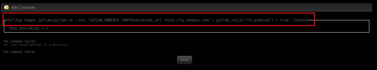

July 15, 201610 yr unRAID OS Version: 6.2.0-beta23 Description: When using a ';' (semicolon) in a variable value, docker container fails when starting and causing an "orphaned image". How to reproduce: Try to pass a variable with a semicolon for instance like this: Variable name: GITLAB_OMNIBUS_CONFIG Variable value: external_url 'http://my.domain.com/'; gitlab_rails['lfs_enabled'] = true; Screenshot: Expected results: Should add the variable correctly to the docker run command and start up the docker successfully. When running it manually through ssh it works fine! docker run -d --name="GitLab-CE" --net="bridge" -e TZ="Europe/Paris" -e HOST_OS="unRAID" -p 45300:80/tcp -p 45305:443/tcp -p 45310:22/tcp -v "/mnt/cache/appdata/gitlab-ce/config":"/etc/gitlab":rw -v "/mnt/cache/appdata/gitlab-ce/data":"/var/opt/gitlab":rw -v "/mnt/cache/appdata/gitlab-ce/log":"/var/log/gitlab":rw --env GITLAB_OMNIBUS_CONFIG="external_url 'http://my.domain.com/'; gitlab_rails['lfs_enabled'] = true;" gitlab/gitlab-ce Actual results: Fails startup (with the error shown in next line) and causing an orphaned image. The command failed. sh: /usr/local/emhttp: Is a directory Screenshot: Other information: More discussion can be found here https://lime-technology.com/forum/index.php?topic=40262.msg483812#msg483812

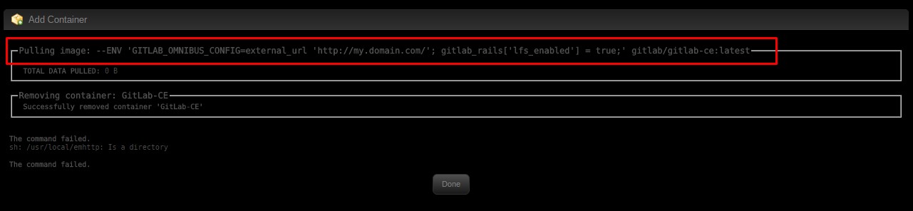

July 19, 201610 yr Author First of all, you should update to 6.2 rc2. What happends if you add the env variable to the "Repository" tag in the template instead? (Right after the repository). I'm not updating until it hits stable. Perhaps someone else would mind testing this on RC2? I tried both adding it before and after. Same thing happened, see attached screenshots: Before: After:

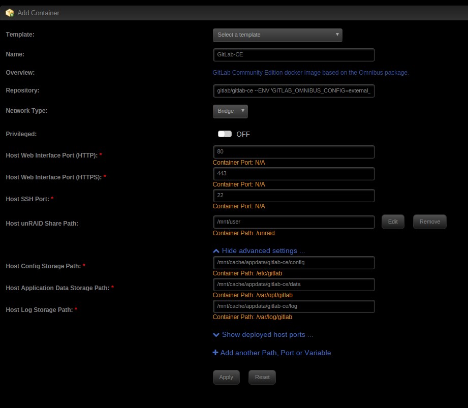

July 19, 201610 yr First of all, you should update to 6.2 rc2. What happends if you add the env variable to the "Repository" tag in the template instead? (Right after the repository). I'm not updating until it hits stable. Perhaps someone else would mind testing this on RC2? I tried both adding it before and after. Same thing happened, see attached screenshots: Before: After: You are using a beta, but not a rc? Why.. Can you post screenshot of docker config also?

July 19, 201610 yr Author First of all, you should update to 6.2 rc2. What happends if you add the env variable to the "Repository" tag in the template instead? (Right after the repository). I'm not updating until it hits stable. Perhaps someone else would mind testing this on RC2? I tried both adding it before and after. Same thing happened, see attached screenshots: Before: After: You are using a beta, but not a rc? Why.. Can you post screenshot of docker config also? I saw in the announcement post that there were some issues with some plugins, for instance CA. So i thought i'd wait until the issues were resolved. But now you guys made me push the button Here is a screenshot of the config (which i posted in the initial post aswell):
