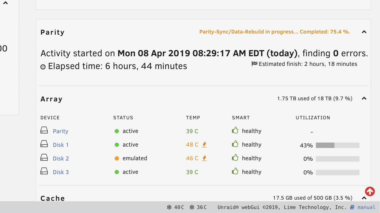

Hi all,
I am attempting to shrink my array from 4 x 4tb drives to 3 x 10tb drives. I have replaced 2 of the 4tb drives with 2 10tb drives and each time did a parity sync and am now looking to remove/shrink the one 4tb drive that is totally empty before swapping the last 4tb drive for a 10tb.
I have read the page on doing the shrink via the user scripts plugin and was able to start the script with no problems via the plugin. I would like to make sure I don’t screw anything up in the process and am looking for clarification.
I left the user scripts page open displaying “closing out this window will cancel the script” but I was under the impression that I was supposed to be able to see a progress bar. How do I see that progress bar, do I have to type ! to see it?
It looks like there is a parity sync running, how can I verify the script is running properly as well and roughly how long will it take in peoples experience.
Once this script/parity sync is done and I go to tools and do a new config, set the disk I want to remove “disk2”to no device and start the array will that disk disappear?
I do not see the checkbox mentioned in the instructions that says “parity is already valid” is this on the new config page or the main page where I do the drive assignments? Will this only show up after the current parity sync completes?
thanks in advance for any input.

The entire process i did so far was the following:
1. Stop array pull the 4tb parity drive and replace with 10tb drive, reassign in the main screen and start array. it did its rebuild/sync and after about 20hours completed.
2. Stop array pulled disk3 drive and replace wiith 10tb drive, reassign disk 3 in the main screen and start array. it did its rebuild/sync and after about 20hours completed.
3. I stopped the aray and then set disk2 to no device and then started the array thinking that since its empty and unused it would not be more complicated then that. It didn't remove the drive and then I did some research and found this clear an array drive method so I started the array back up and did step 4.
4. Installed  user scripts plugin and downloaded clear_an_array_drive.zip and created a folder in the correct plugins directory "clear an array drive" and put the script and description file in there. Additionally added the clear-me folder in /mnt/users/disk2 which was totally empty and then started the plugin.
Now after all these steps I am at the stage of having a running parity sync which I am not sure if its part of the clear an array process or because I set disk 2 to no device and started the array as well as a 10tb parity drive a 10tb disk 3, an empty 4tb disk 2 which i am trying to remove and a partially full disk 1 which I plan on swapping with my last 10tb drive once disk 2 is full removed.
When you say "After you do a New Config, it will give you a parity valid checkbox when you go to Start the array." where will i see this checkbox, after i hit the button start array, or is it somewhere on the main page or is it on the new config page?
Is the way I am doing this, thus far ok and how can I see the progress of the clean an array disk?
PS
This is not an old array with a lot of data, its pretty new I have just not realized all the features of unraid and now want to use the server for a gaming / nas box and having 3 drives allows me to remove a drive cage so i can fit a full length gpu with the added benefit of 20tb usable vs 12tb usable so the only drive that has data on it are the cache drives and disk1.
PS
Sorry if this is long winded but just trying to give all the background info. My end goal is to have just the 3x 10tb drives.
Edited by nanoblock

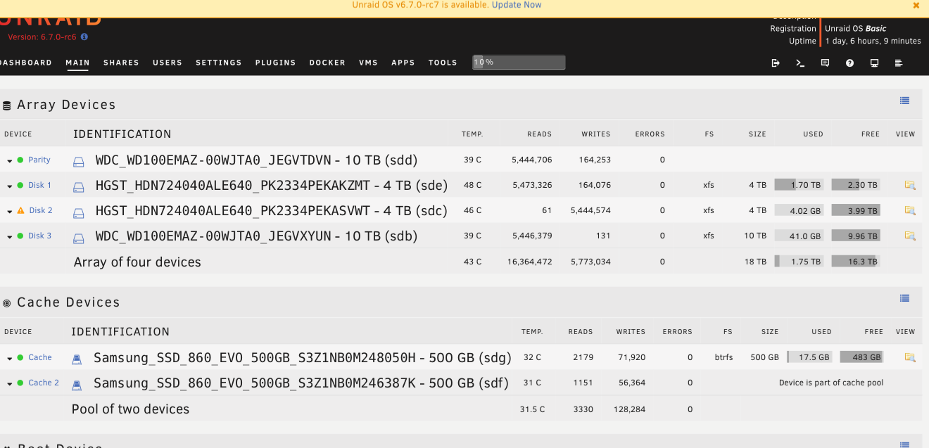

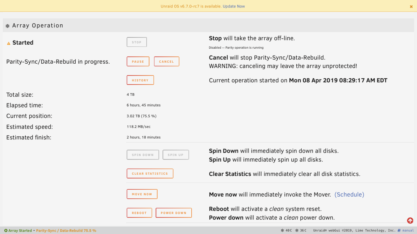

It looks like the parity sync / data rebuild completed. Is there a way for me to see if the clean disk is done so I can stop the array and do a new configuration?
Are you sure this is what you did? Because that can't possibly be the correct instructions. The folder path /mnt/user/disk2 (not users) is actually a user share named "disk2", not the actual disk2. And that user share named disk2 could exist on any disk. The path for disk2 would be /mnt/disk2. And the path /mnt/users/disk2 would actually be in memory.
Based on everything else you said, and those screenshots, I would say that you have rebuilt the empty disk2, not cleared it. It's unclear what if anything the script could have actually done.
And, in case you don't know, an empty disk is not a clear disk. An empty disk has a filesystem on it that contains an empty top level folder. A clear disk has nothing but zeros on it, so no filesystem.
Personally, I usually recommend people not even bother with that "clear then remove script". It should work if you understand how to use it and do everything correctly, but it doesn't really save any time. Instead, you can just New Config and not assign the disk(s) you want to remove, then let it rebuild parity. And it would certainly be simpler and faster than what you have already done, since you still haven't accomplished anything.
In fact, you could have removed disk2 (and moved disk3 to the disk2 slot if you wanted) and then New Config and upsize parity all in step 1 and that part would be done and you could then upsize disk3 (or disk2 if you had moved it to that slot).
You still have options on how to proceed from here. You can try to preserve parity by using the script again to clear disk2, and then New Config, remove the disk, move disk3 down to slot 2 if you want, and parity would still be valid.
Or, you could just New Config without the empty disk2, move disk3 to slot 2 if you want, and let it rebuild parity.
Either way will be a similar amount of time. The script has the advantage that parity is valid throughout, but if everything else is working well, and you have backups of anything important and irreplaceable (you should regardless) then there is little risk to rebuilding parity.
Let us know what you want to do, and tell us exactly how you plan to proceed so we can make sure you have it all correct.
