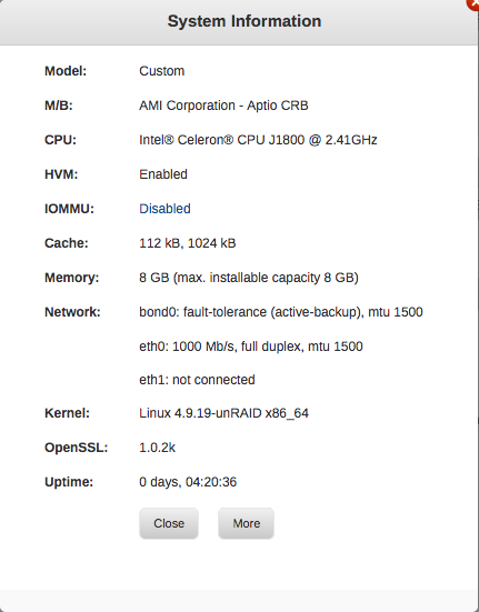

April 6, 20179 yr Playing Around The idea looked like fun so I tried this on my QNAP TS-251 and the results are seen below. I am not sure if I will do anything with it but it was fun and very easy.
