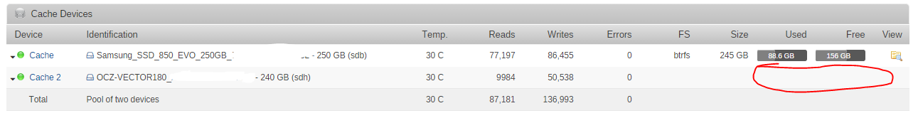

2nd Cache Drive Not Showing Info?
Just added a 2nd cache drive for the first time and it doesn't look to be loading some of the information.
Is this expected?
Thanks!
Yes, it's normal.
Am I misunderstanding how multiple cache drives work? Does it not add on the additional space? If so why does it not show the space you have?
Thanks!
Cache drives are organised into a cache pool using btrfs. Think of it kinda like RAID 5, If you have 2 drives they will act like a RAID 1 mirrored array.
So if you have 1 250GB drive you will have 250GB total.
If you add a second 250GB drive you will still have 250GB total but it will now be protected with a mirror.
In your case if you now added a 3rd 250GB SSD to the cache pool your total should go up to around 500GB.
