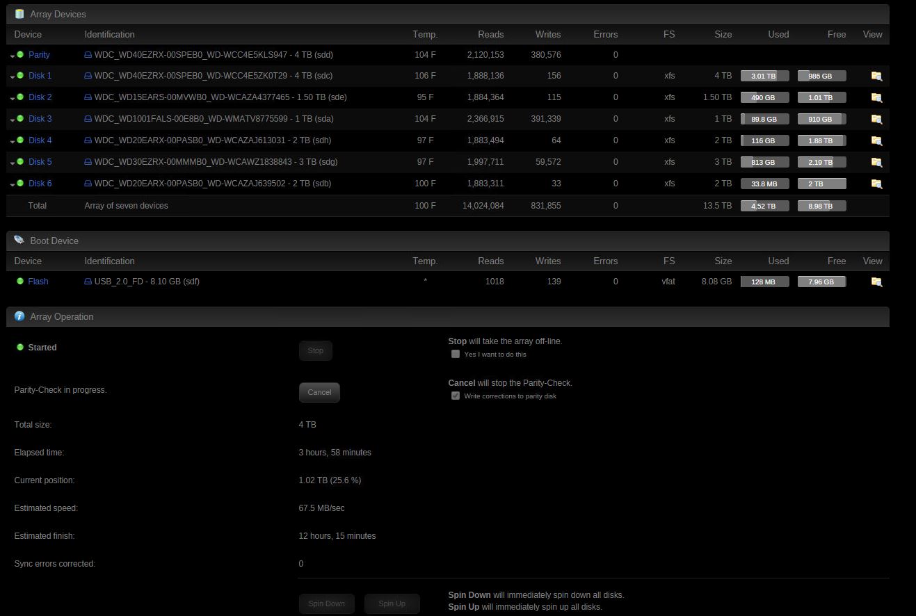

I've noticed while I am currently running a parity check, Unmenu states that there is no array started.  Which is definitely not true.  Unmenu has always worked and showed accurate data in the past.  Any ideas?
unMenu is incompatible with v6.1+ unless you make some modifications to the actual script.  Details will be somewhere in the unMenu thread.
Luckily, there's very little reason nowadays to even have it installed as I don't believe that there is anything that unMenu can do that dynamix (possibly in conjunction with a 6.1 compliant plugin or 2)  can't do.
