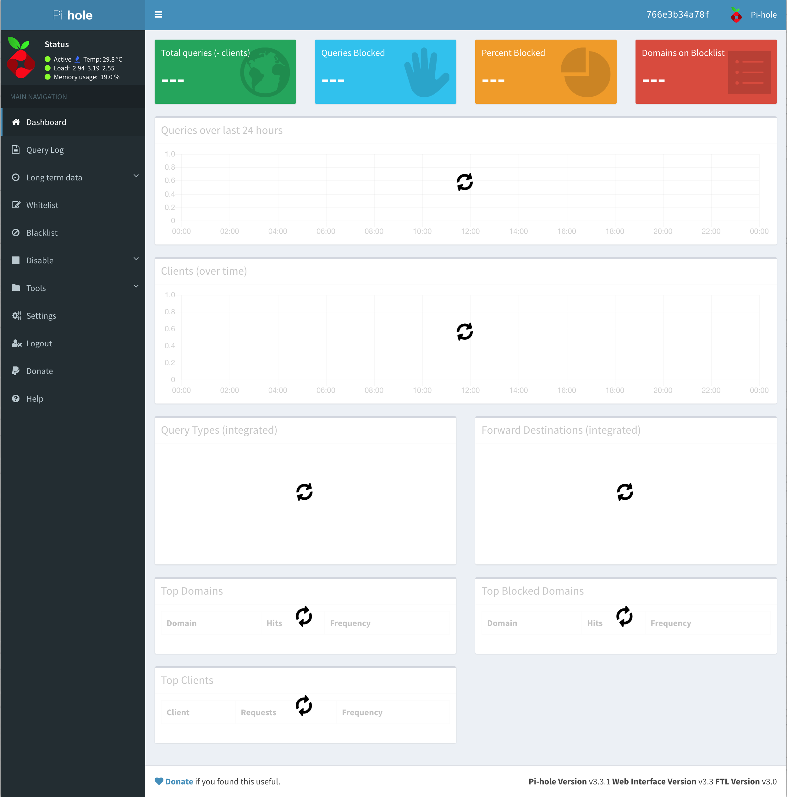

Installed the docker on two networks -- worked great on one / shut off all DNS on the other. Going to try again on the second network but in the meantime, I have a few questions.
1) When I go to http://192.168.2.25/Docker it takes a long time and then I get not available in red for the version of all the dockers I have installed. The dockers also don't have icons -- instead just circles with white question marks. Am I supposed to whitelist something for Dockers to work properly? When I check the dashboard nothing is being blocked.
2) When I started reading this topic in the first few pages there was mention of running a script every night to clear out the logs -- is that still necessary or can log length now be set inside the docker?
On the second network, I have managed to get PiHole working but Dashboard and Query Log show no data -- all the settings are identical to the one that is working properly except under status in the top left Load is red on the one having issues. The unRaid server should not be under any high load.

Just updated the docker and seeing no data at all and the log is full of;
Found pihole-FTL process with PID 435 (my PID 699) - killing it ...
Any ideas?
Just to add, I've had to kill the docker as it was using huge amounts of CPU and also crashing the unraid GUI.
Anyone else having the same issue, or is it isolated to me?
Hoping for a fix, or is there a way to roll back?
Edited by WannabeMKII
Different PIDs, but seeing the same thing. WebUI doesn't load at all
