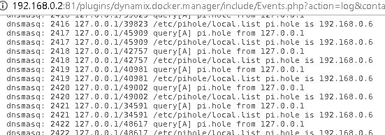

Has anyone has any issues with PiHole taking up an insane amount of space for the Docker disk image? With PiHole enabled, it quickly eats up my Docker disk image space. It's set to 40GB, and after removing PiHole just now the usage went from 76% down to 22%. I have no idea what is causing it - I set it up following SpaceInvaderOnes guide. It works great otherwise - just destroys the space and I need to remove it to clear it up again.
Setup below, am I missing something?
Yep I got already will give it a look.
Yes, for some reason this container logs every single dns request to the container log and keeps it. Stop your entire docker service and turn on the log rotation and limits in the unRaid docker settings. It will keep the problem at bay.
I've already got log rotation on. Here's my docker settings:

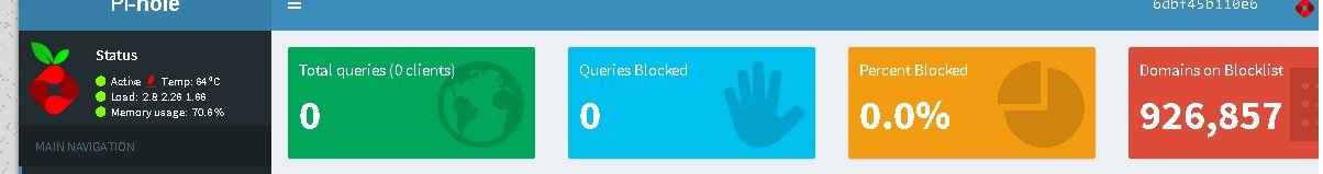

But since some days i noticed that if i login to the admin, it doesnt show any information..
Hows that possible? Seems to work just fine?
Ive read somewhere that it might be that the logs are full, but where are they? If i "console" into pi hole, i cant "move" into directorys or use vim or tail or anything.
Incase anyoen wonders, b efore pi hole i have another dns cache (for serving windows updates/steam and so on)
Is the block list too big?
Edited by nuhll
20 hours ago, nuhll said:
I use this docker since some weeks/months. No problems so far.
I believe that I'm having the same problem. I was recently ready to burn my new unraid install because I couldn't figure this out. I previously had the stats updating but pihole itself wasn't able to update the blocklists. I deleted the docker and recreated it, now everything seems to work.. I.e. ads are being blocked, but the query #s aren't updating. i thought it was broken until I saw your post and decided to double check. At first I thought I was having network issues..
dnsmasq: warning: interface br0 does not currently exist
^^ Is this a problem? I'm pretty sure br0 does exist.. it's in my routing table in unraid.. Maybe the docker doesn't see it as br0?
dnsmasq: 26 127.0.0.1/51118 query[A] pi.hole from 127.0.0.1
dnsmasq: 26 127.0.0.1/51118 /etc/pihole/local.list pi.hole is 192.168.1.2
From my point, if query[a] is shown, its working.
Its just not updating GUI (but i might bewrong)
I also have this br0 "error" in log...

After further testing.. my pihole doesn't appear to be working at all. Which additional logs should I provide? This is a brand new install following the spaceinvaderone video, same settings.
Having the same problem.  My actual docker pi-hole log was huge, I decided to nuke it and see if that helps.  Going to test it all out in a bit.
Edit - Nope still can't see query stats/etc.  Getting very frustrated with this :(
