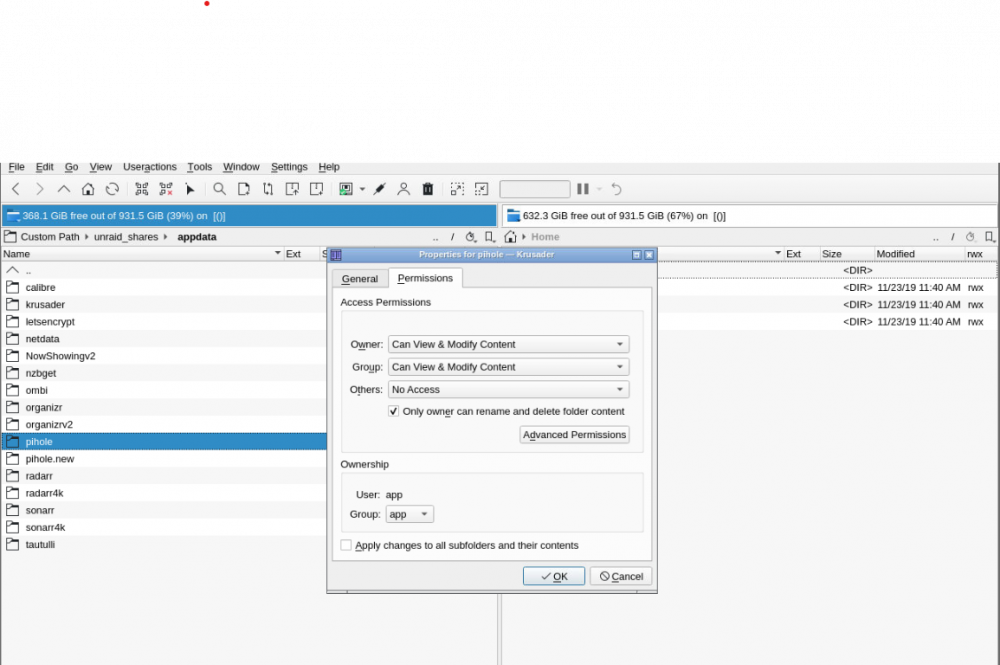

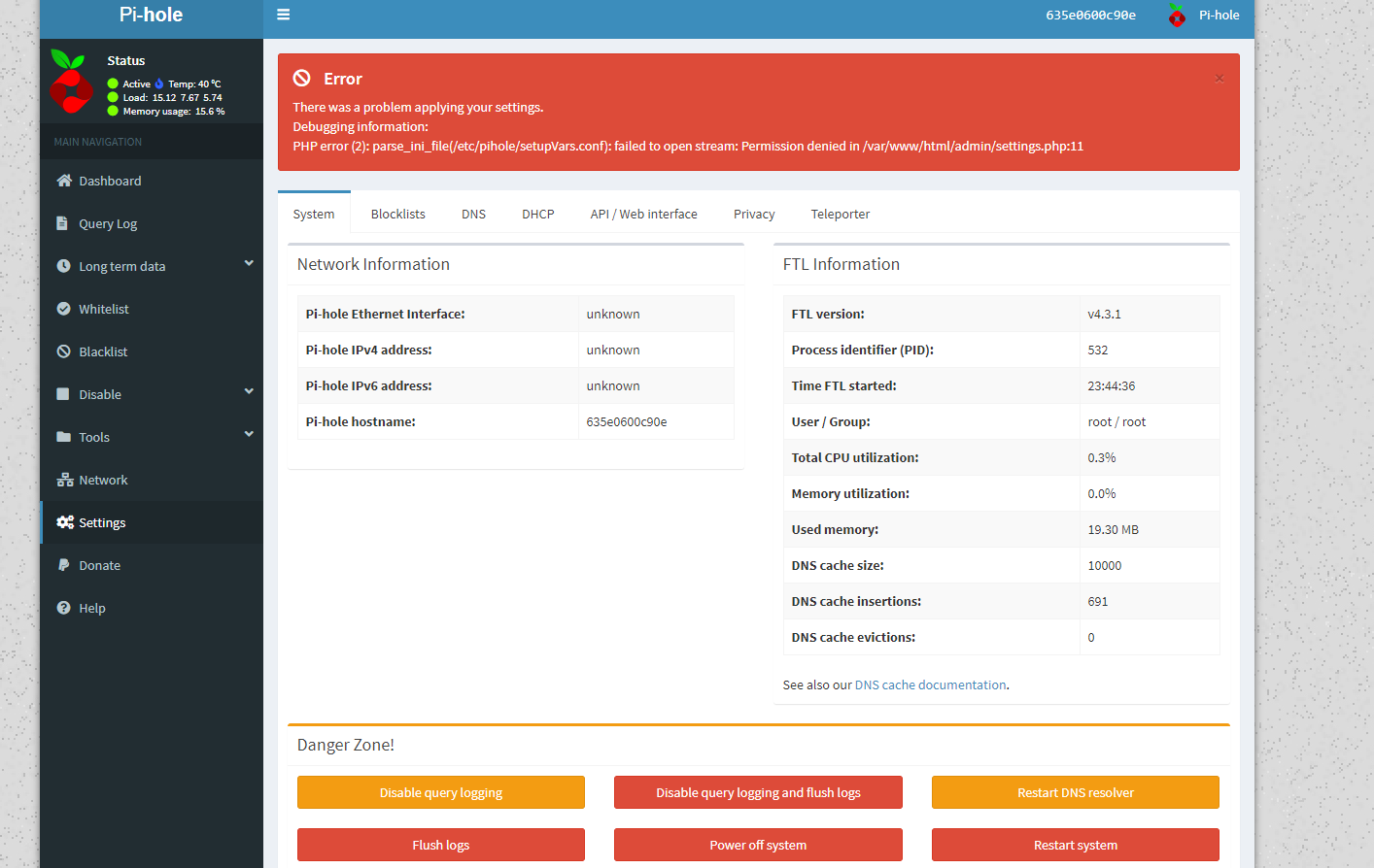

Has anyone seen this error? I have been running pi-hole with no problems for months, and all of a sudden I am getting this, yet pi-hole still runs properly and is actively filtering. I have made no settings changes, the only change I can think of since I last checked is the Unraid 6.8 official update. Thoughts?
I fixed the problem by using the Krusader docker and changing the permissions for "Group" from View to View and Modify and now things are all good. Strange because I haven't made any changes or anything to the folders or docker container previously but everything looks good now.
