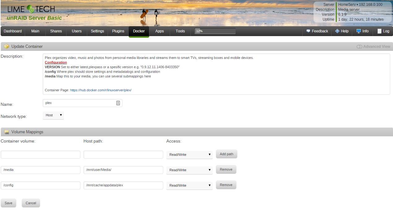

Post a screenshot showing the volume mapping of one of your dockers.

Does this help? and ah okay, I wasn't sure on sizing, so I just set it up as that size a few months ago
If you don't have a cache drive the docker can't store its config where you have told it to.
You seem to be missing some very basic ideas about using dockers, so I would suggest you read the stickies, ask questions, and just start over with a new smaller docker.img and concentrate on getting just one docker working correctly before trying to add any others.
