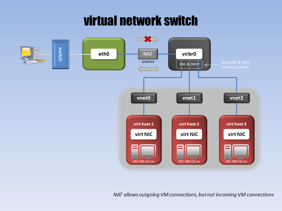

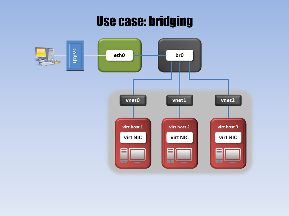

Are you sure you are talking about VM'sand not dockers? There are no options for host/bridge for VM's. You can only choose the virtual bridge, which gives your VM access to the outside, but you can't connect to the VM, or the public bridge that gives you an IP from the dhcp server.
Ah, I guess I was confused. It's looks like it's just br0, virbr0 and docker0. I don't know what any of those do except br0 i guess lol. It pulls an IP from dhcp on br0, and I'm able to see the network drives from the vm. Is there anyway to isolate it?
