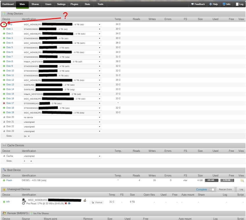

Thanks, Frank1940.  If I read what you suggested correctly, clicking the symbol (see photo) does not change spin up or down.  Clicking the drive itself gets me into the drive's settings page but nothing is offered there to immediately spin down or spin up the drive.

You are right.  If the array is stopped there is no little symbol to spin change state.
