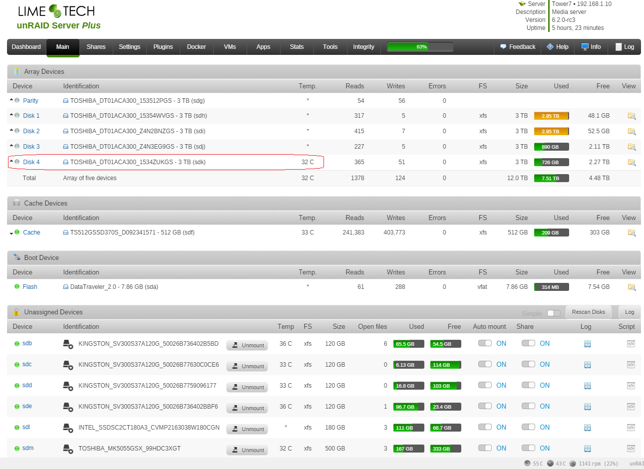

I don't know if this started with rc3 but I noticed something that I don't think happened before, when clicking a disk in standby from the main page, the disk spins up to get SMART info, it then stays spun up but unRAID still shows a grey ball, temp is displayed and it never spins down again unless you click the spin up or access it to turn it green, only then it will spin down after your selected time.
P.S.: same happens when getting the diagnostics to any standby disk, that's how I noticed this.
Interesting result Johnnie => I just tried that and I get different behavior.    If I double-click on a disk in the Main page, I get the disk info page, but for the Last SMART test results it shows "Unavailable - disk must be spun up"
... and the disk isn't spun up.
The different behavior could be due to different drives (my 6.2 system uses all older 2TB WD and Hitachi drives); different chipsets (my 6.2 system is on an old SuperMicro C2SEA board); or some other configuration difference.

I tried in two different servers with different disks and get the same, at first I also see "Unavailable - disk must be spun up", but after a few seconds, after it spins up, it show the SMART info and if you go back to main and click the same disk it already spun up and no more "Unavailable - disk must be spun up".
Well ... based on your post I went back and had a look at the server status.  VERY interesting result ...
When I tried this a bit ago, I had tried it on 3 different disks [2 WD's -- an EARX and an EADS;  and a Hitachi HDS732020BLA642 ].  Just for grins I took another look at the server status, and indeed the Hitachi now shows the temp, and was clearly already spun up, although the page didn't show that [i determined this by copying a file from it, and the copy started instantly at full Gb speed].
Interestingly, once I started the copy, the status on the Main page changed to a green ball and the Dashboard now indicates it's spinning (neither of these was true until I did the copy).
But neither of the WD's had these symptoms.

Can confirm that this issue doesn't happen with WD, it does happen on all Toshiba, Seagate and Samsung HDDs I tested.

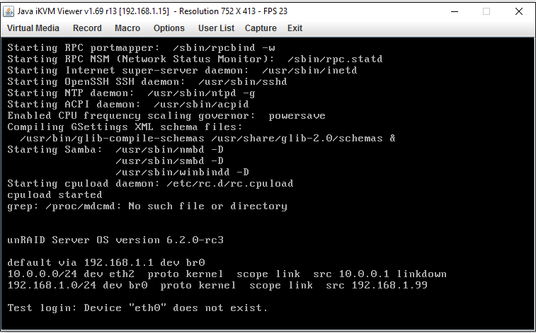

Since the advanced network configuration introduction unRAID is no more hardware-agnostic regarding NICs, replacing a motherboard (should be the same replacing just the NIC) results in no network.
This happens even if the board replaced is the exact same model as in the example below.
I really like and need the advanced net config, but if it's not possible to make unRAID detect a NIC change I believe it should be mentioned in the release notes that network-rules.cfg needs to be deleted after a NIC change.

Definitely agree this should be highlighted => that's a fairly major change in UnRAID's behavior ... one of the BIG advantages of this nifty little guy has always been that you could just move all your disks to a new system; boot to the flash drive ... and life was good  :)
... for that to be no longer the case -- especially even on the same make/model motherboard -- is a pretty big change in behavior !!

Just to add to my previous report, today I've done a lot of upgrading and trading boards on my servers and this issue doesn't always happens, didn't pin the reason down but maybe only when the board has multiple NICs, I traded some single NIC boards without issue, maybe the logs I uploaded before can provide some clues.

The file "network-rules.cfg" is only created when more than one NIC is present in your system and is used to make interface assignments persistent across system boots.
There is a detection mechanism in place which deletes the file when a change in the number of NICs occurs.
As you observed this is not 100% full-proof. In case a system has multiple NICs and these are changed, without the number of NICs changing, it goes undetected. Though one port will become eth0, and it might be necessary to move cables to restore connectivity. This will depend on how the network is configured (bonding, bridging).

Would it maybe be a better to have the change detection rely on not finding any of the original MAC Addresses instead of just the number of NICs?
