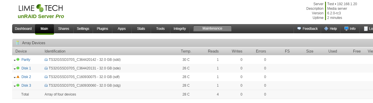

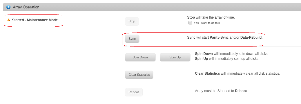

Start with a stopped array with a disable and unassigned disk, assign a disk to the disable slot and start the array in maintenance mode in order to run xfs_repair, a rebuild doesn't start, if you then run xfs_repair on the disable disk that's when it begins writing to it, in this example, md2.

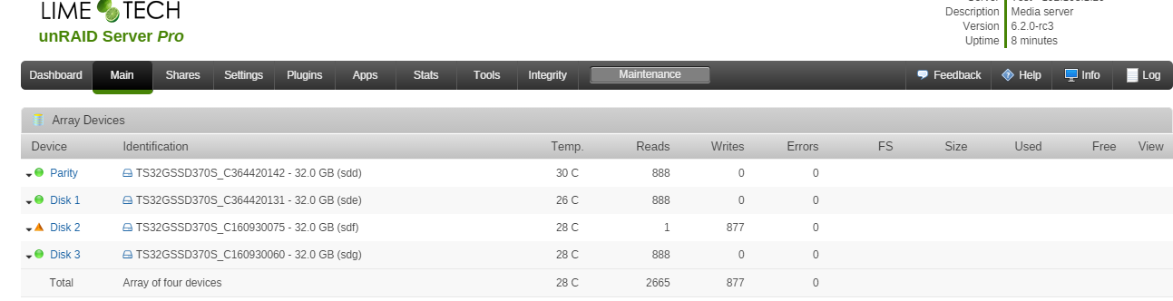

After starting xfs_repair on md2:
"Maintenance mode" is not a md/unraid driver state.  It just means md/unraid driver has been started but no array devices have been mounted, and thus no shares exported, etc.
That does look kinda strange, I'll try to reproduce.
What was odd about the screenshot was that disk2 was showing non-zero write count, and parity was showing zero write count on xfs_repair.  Explanation: first you must have clicked 'Check' without changing the option, which is -n, which means do not write.  That explains why parity writes count was 0.  The reason disk2 has a non-zero write count is that the driver does not distinguish between a read failure on a device due to I/O error vs. due to disk being "invalid" (meaning, in driver, when I/O error occurs disk is marked "invalid" for that I/O, and when we're dealing with a replacement disk, all blocks start out "invalid").  Anyway, when xfs_repair does its reads to check the file system, the md/unraid driver calculates the data using on-the-fly reconstruct.  It then writes the reconstructed data to the target disk (disk2).  This is what you need to have happen if a reconstruct is happening, and as I mentioned earlier driver doesn't take into account whether or reconstruct is active or not in this case (where a disabled disk has been replaced).  Bottom line: it's working correctly and this is a rare corner case.  I guess a side effect is that it slows down the operation because it needs to write two disks (parity and disk2) or three disks (parity, parity2, disk2 - if you have parity2).
That's what I assumed was happening, I don't expect to see this much in the future but it's good to know for sure what's going on, so in case someone does again we can warn them, like the thread I linked xfs_repair had been running for 2+ days for a 4TB disk when it usually takes much less than a day.
