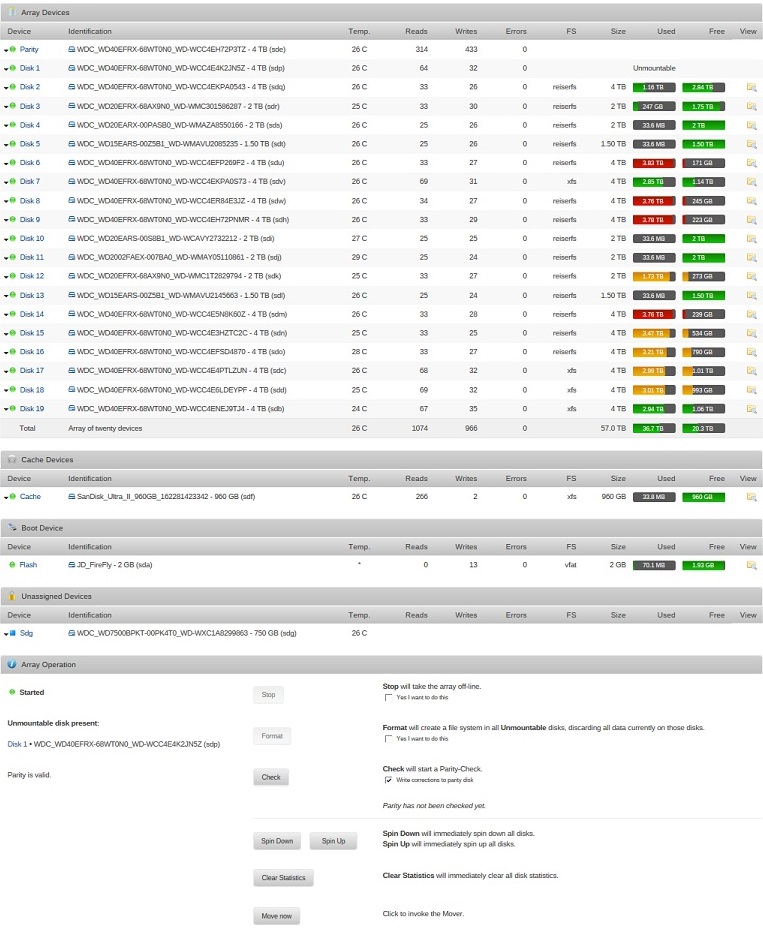

Restarted array in Maintenance Mode. Only disk 1 was showing as unmountable. I let the rebuild take place (which hopefully was a good course of action) and disk 2 is showing as fine now.
So it seems my only problem that I'm aware of at the moment is disk 1 won't mount and I cannot start the array normally. I have updated the original post above.

Forgot screenshot:
