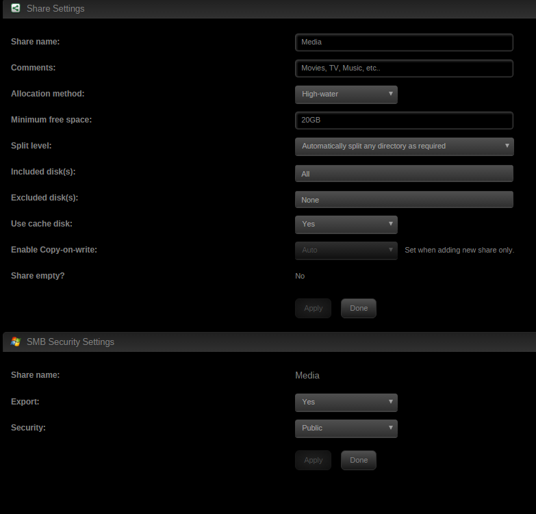

In Shares the setting for the two paths i added past the auto added config are as follows
One is set to my mnt/ user/media folder
it is set to use all disks and cache YES export yes security public
the other to a mnt/user/Transcode folder
is set to cache only export yes security public

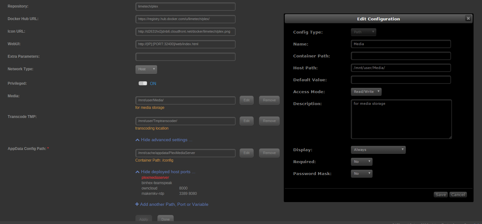

Interesting.  Can you switch to advanced view in the top right, then hit edit on one of those and post the screen shot.

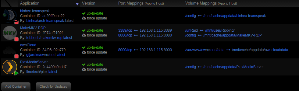

Doesn't look to me like a problem with Plex but more how the container is setup originally.  So, just to clarify, you can't add any more volumes via the docker webui?

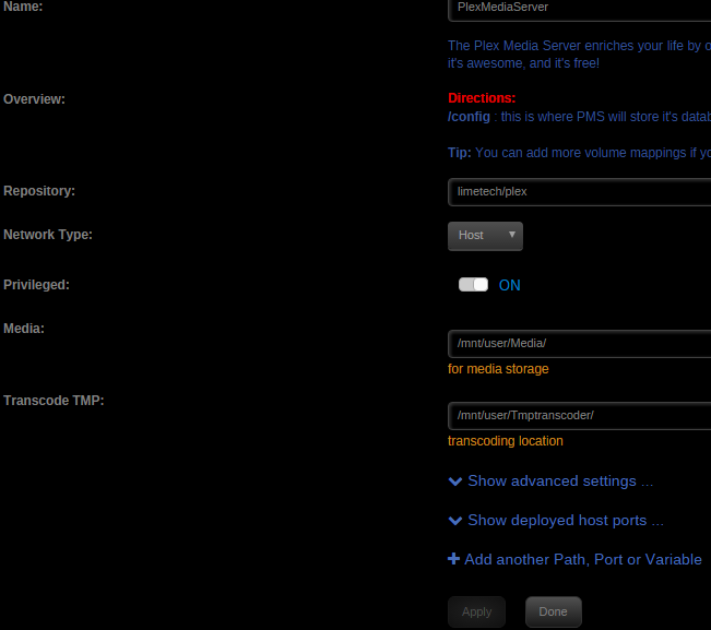

As requested new screens i went into adv view expanded it so it shows the config path and opened up a edit on the media folder.
Also to note under deployed host ports the pms one is red. adding a couple screens to this and another post after for extra info
next screens
You need to set a container path (like CHBMB said).  Something like /Media  You will then find your media files within /Media inside Plex

So this is a share problem with my dockers in general?

No, there's no problem, you haven't set it up correctly.
In your post here  where you've edited the container you need to fill a value in for "container volume" ie a mount point INSIDE the docker container.
I would suggest /media
I think we all learned something here.  I never really realized that dockerMan would allow you to enter incomplete information on the edit screen and not complain, and everyone learned that you can't take the label underneath the host mapping at face value because a description if entered will be displayed instead.

Thanks again guys, working great. That makes the docker set up make sooo much more sense to me.
