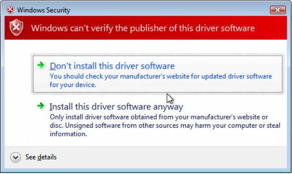

Attached is a pic of the 3 drivers.  Top one doesn't install correctly and middle and last one both cause the BSOD.  Also, I was using only one core but not Core0 (I changed this and same result).
Which series of drivers should I be using for Windows Vista??  XP or Win7 or one of the server sets (e.g. 2k3, 2k8 etc)?
The other thing I noticed is that none of the virtio drivers have a Microsoft's WHQL signature.  Could this also be an issue?
