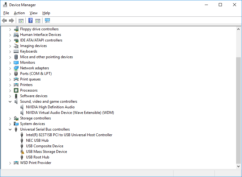

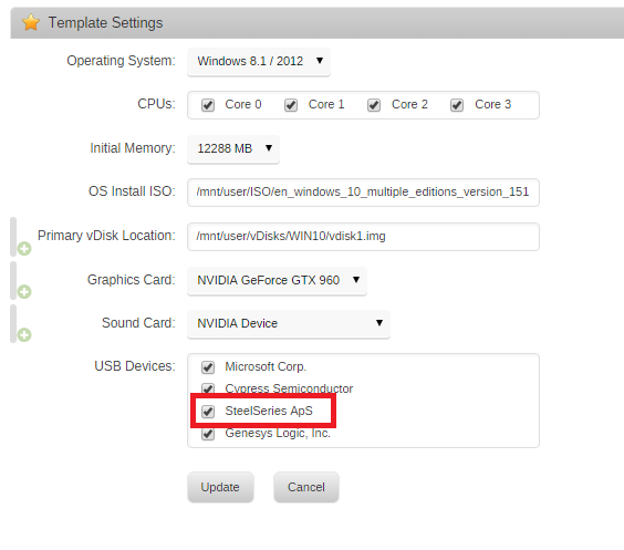

August 5, 201610 yr Author My apologies for not being clear enough. [*]I have the device plugged into the machine [*]I have the device selected in the USB list on the VM (see attached image) [*]I see an unidentified Mass Storage Device, unsure if that is normal (see attached image) [*]I do not see the headset under sound device [*]Audio being passed through the Nvidia card via HDMI sounds fine tower-diagnostics-20160805-0616.zip
August 5, 201610 yr I can see from the qemu log that one of the USB devices have a problem, and it might be the headset. I can also see problems regarding a USB devices being reset. Have you tried switching USB ports and disabling USB 3 if you have? You could try to use a USB 3 controller in the VM per instructions in this post. Another thing not really related to USB pass-through. You should not assign all the cores for the VM. Leave at least one for unraid itself. Which version of unraid do you run?
August 5, 201610 yr Author I can see from the qemu log that one of the USB devices have a problem, and it might be the headset. I can also see problems regarding a USB devices being reset. Have you tried switching USB ports and disabling USB 3 if you have? I have tried using different plugs, I haven't specifically tried a USB 2 plug (I can try that tonight) You could try to use a USB 3 controller in the VM per instructions in this post. Interesting, at one point in time I had applied this patch, is it possible that if you manually go into the edit and check / uncheck devices does it reset this setting? Another thing not really related to USB pass-through. You should not assign all the cores for the VM. Leave at least one for unraid itself. I'll do that also tonight Which version of unraid do you run? 6.1.9
August 5, 201610 yr I can see from the qemu log that one of the USB devices have a problem, and it might be the headset. I can also see problems regarding a USB devices being reset. Have you tried switching USB ports and disabling USB 3 if you have? I have tried using different plugs, I haven't specifically tried a USB 2 plug (I can try that tonight) You could try to use a USB 3 controller in the VM per instructions in this post. Interesting, at one point in time I had applied this patch, is it possible that if you manually go into the edit and check / uncheck devices does it reset this setting? Another thing not really related to USB pass-through. You should not assign all the cores for the VM. Leave at least one for unraid itself. I'll do that also tonight Which version of unraid do you run? 6.1.9 If you edit the XML and then go edit the VM Template you loose the changes to the XML you did. If you don't get it to work, you could try the latest 6.2RC to see if it resolves the problem.
