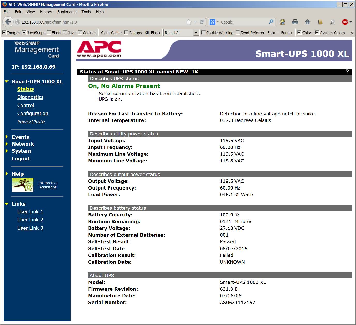

No, it doesn't  I have used APC UPSes for decades, with the network management cards.  They do not affect the serial port.  In fact, I have one on an unRAID server right now (Smart-UPS 1000 XL) that uses the serial port and has a network card.
