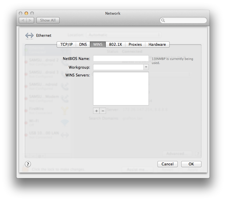

System Preferences -> Network -> Advanced -> WINS looks like the attached file. The NetBIOS name is automatically taken from the Computer Name.

I don't have a Workgroup set on my Macs.
