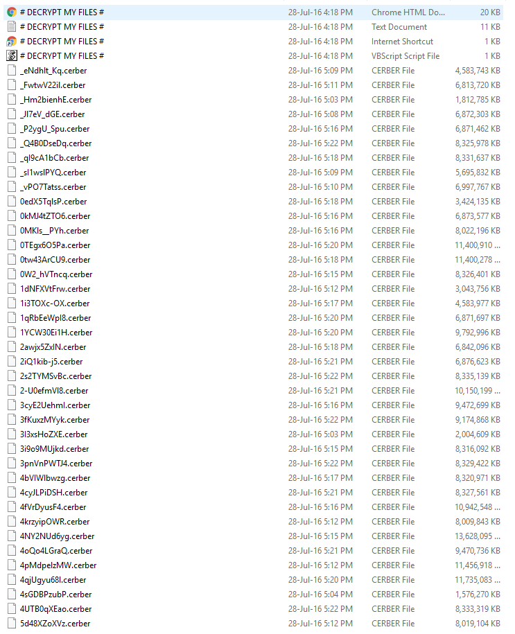

August 10, 201610 yr Hi All, From reading around I know nothing can be done about this but thought it may be worth warning others as I was unaware that this was possible. So one of the computers on my network got infected with "Cerber Ransomware" and all their files encrypted due to some silly internet exploring and I assume stupidly clicking on a bad link. Wiped that PC and upgraded and used a backup so all good there. But when I checked my Unraid server all 6Tb of files were encrypted!! Which I didn't think would happen as its running Linux so there is no windows and the shared drives were not even mapped on the originally infected PC. Anyway I have no backup of the server so will need to cut my losses and wipe it and use this as an opportunity to upgrade to V6 of Unraid Screenshot of what the files look like on the server:

August 11, 201610 yr Which I didn't think would happen as its running Linux so there is no windows and the shared drives were not even mapped on the originally infected PC. Drives don't need to be mapped. The malware will attempt to connect to every IP on your network. Looks like the names are also encrypted. I guess someone could write a plugin with file name trigger to lock the shares? Skickat från min iPhone med Tapatalk Actually, off and on I've been slowly putting together a Beta build of a plugin for exactly this. I've been a bit lazy and haven't finished it as of yet, but I guess now that I've just stated it publicly I should get off my ass and get it done.

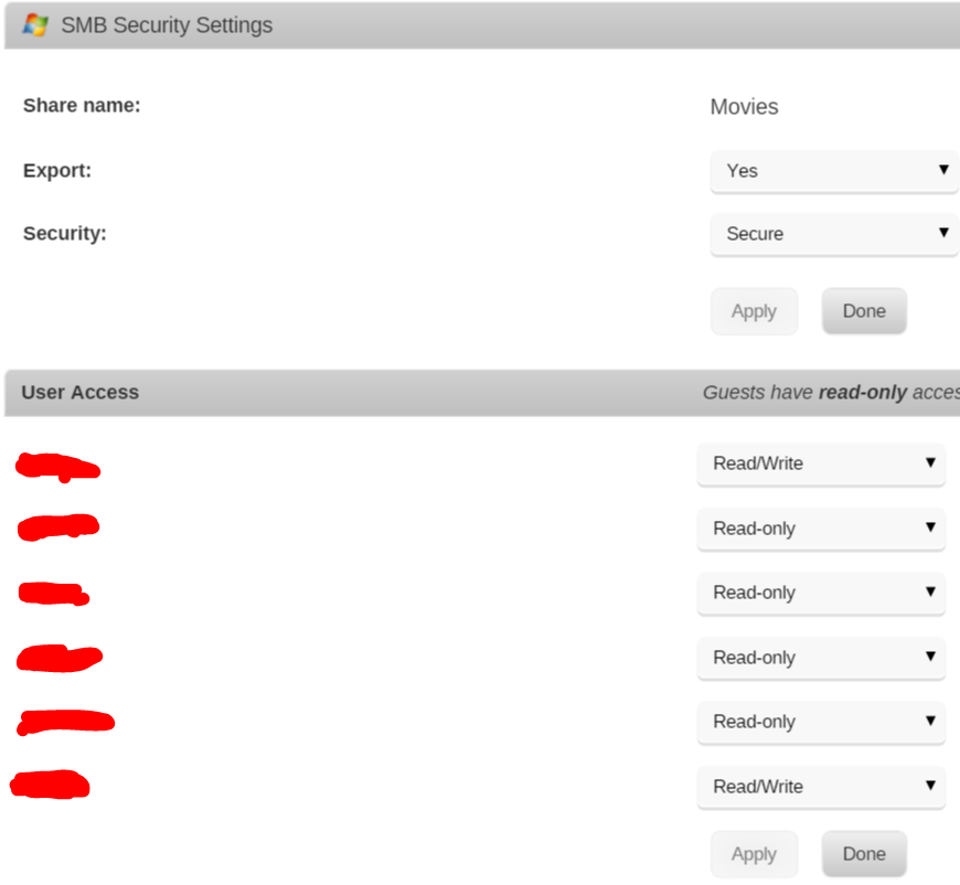

August 11, 201610 yr Does setting the shares to Secure or Private provide a mechanism to also mark them as read-only? My main media server is VERY static => it wouldn't be all that much of a hassle to have to jump through a couple hoops to write data to it; and if it was otherwise "write proof" that would certainly eliminate any ransomware activity. Unraid 6.2 certainly does, can't remember the older versions but pretty sure they do as well. Attached is my Movies share. It is shared as secure. So guests have read only access (visitors can access the movies on their laptops). There are 6 unraid users set up. The first one has write permissions (used by kodi boxes, android or libreelec) and the last one has it as well (my android phone). The other users are the windows devices in the house and are all set to read only. If I need write access on a windows machine through file explorer, I just change that specific user to read/write, hit apply and I'm good to go. Once done with writing, I set it back to read-only and hit apply. Other shares like Pictures are set to Private, so guests cannot even read (I don't want all the visitors to be able to access family photos and such on their laptops). Flash drive and the docker config folder shares are also set to Private since they may (and often do) contain passwords in plain text.
August 12, 201610 yr What does your "Users" page look like? I've always just left my media server with only root and no defined users. If I define some users, does that eliminate external access to root? And does this make it more complex for my clients to access the media ... or can I simply log in and let those boxes "remember" the credentials, but have those users set to read-only? i.e. if I define "Living Room", "MBR", GuestBdrm", etc. as read-only users will this provide protection against a rogue process writing to the server? And does this protect against writes to the disk shares (i.e. NOT to a user share)? Clearly I can set all the user shares as you've shown above; but what about direct access to the disks? [Or if I simply don't export them, does that protect again that?]

August 12, 201610 yr Okay, I'm definitely upset that I didn't do this LONG ago !! It was oh-so-simple ... and my primary media collection is now completely read-only, so that's about 25TB that's now "safe" from ransomware !! Even with double sets of backups for it all, it would be a real PITA to have to reload the server, so the added protection is clearly a good step. Now I've got to do that for ALL of my shares on all of my servers -- a project for the next few days => I want to outline what permissions I need for which PC's and ensure they're all set up to work smoothly. I DO feel very well protected from the disastrous consequence a ransomware attack might have with my 3-layers of backups; but it's still a good idea to set up the UnRAID boxes so they wouldn't be impacted at all if one of my PC's was to indeed get "hit".
