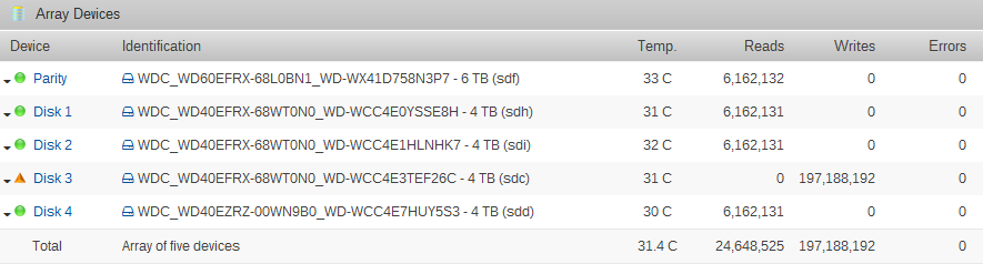

I'm not rebuilding by GUI? I've only run the xfs_repair command at this point. Also from the screenshot I just attached my data appears to be invalid. Could that be why it's taking so long?
There's something wrong going in there, xfs_repair does mostly reads, disk is not rebuilding so I don't know what all those writes are about, maybe because you have a disk assigned a slot that is invalid at the moment.
You should cancel and either rebuild the disk first and then run xfs_repair or unassign that disk to run xfs_repair on the emulated disk.

First, I hate to stop it when it's been running for 2 1/2 days and is almost complete. Second, I have already run a rebuild on this disk via GUI and after completing it showed up as green but was still "unmountable". At this point in the repair/rebuilding process I'd like to let it complete. Do you see any major concerns with that?
If the disk was rebuilt what happened to make it orange and needing another rebuild?

Whatever you did, disk3 needs to be rebuilt again, this won't make it mount, but it has to turn green, after the rebuild is done you'll need to run xfs_repair.
