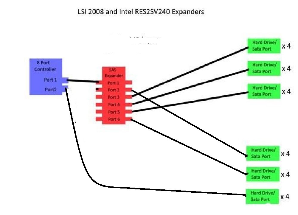

I'm still trying to wrap my head around the different configurations on how to hook up 24+ drives. I've also noticed a lot of question around using expanders. I've made some terrible diagrams in paint to help visually.
I've been hung up on the different ways to connect the controllers to the sas exapnders, and what max speed the resulting drives will have available to them.
I'm going to try to have the questions and hopefully the answers universal so it's helpful to all. These examples are how to connect 24 drives. Of course there is also on board ports/controllers, some people may want to add a couple SSDs for cache and increasing the needed amount of ports. Everyone will have their own optimal configuration. Hopefully we can have some discussion about different configurations in this thread.
Some info on the diagrams bellow:
  • Each black line is a cable.
  • 8 Port controller is actually a 2 port controller with 4 channels/lanes per port for a total of 8 channels/lanes per card. This can be a Dell Perc H310 or IBM M1015 for example. There are others but these seem to be the most popular and been used with the expanders before so they are compatible.
Connection from the expander or controller (if not using expander) to the hard drives will use a SFF8087 to SATA (forward breakout) cable, therefore allowing 4 drives per expander/controller port.
20111227154239292_large.jpeg?v=1459325897
Connection from controller to expander uses SFF8087 to SFF8087 cable
Controller to backplane with built in expander would also use the same SFF8087 to SFF8087 cable
2 Controllers and 2 Intel RAID SAS Expander RES2SV240 (Shown in Dual Link)
1 Controller and 1 HP 6Gb (3Gb SATA) SAS Expander (Dual Link)
3 Controllers, Direct Connect
1 Controller 2 Intel RAID SAS Expander RES2SV240

3 Controllers, Direct Connect            - 320MB/s        - No PCIe or expander bottleneck possible DMI bus bottleneck
2 Controllers and 2 Intel Expanders - 205MB/s        - PCIe 2.0 bus is the bottleneck (12 drives on one PCIe slot)
1 Controller  and 2 Intel Expanders  - 110/125MB/s - PCIe 2.0 bus is the bottleneck (24 drives on one PCIe slot)
1 Controller  and 1 HP Expander      - 95MB/s          - Expander is the bottleneck
So a single card with 2 4port SAS2 links would be able to provide connection of 24 drives at 185MB/s with the use of an expander if no bottlenecks are present. Each of the of the ports of the HBA will need to connect to 12 drives via an expander. The HBA would need a total 4400MB/s of bandwidth to run at max speeds. But the PCIe 2.0 x8 bus max speed is between:
2600MB/s /24 = 108MB/s per disk
3000MB/s /24 = 125MB/s per disk
So the max speed per disk on a single PCIe x8 2.0 slot is 108-125MB/s
