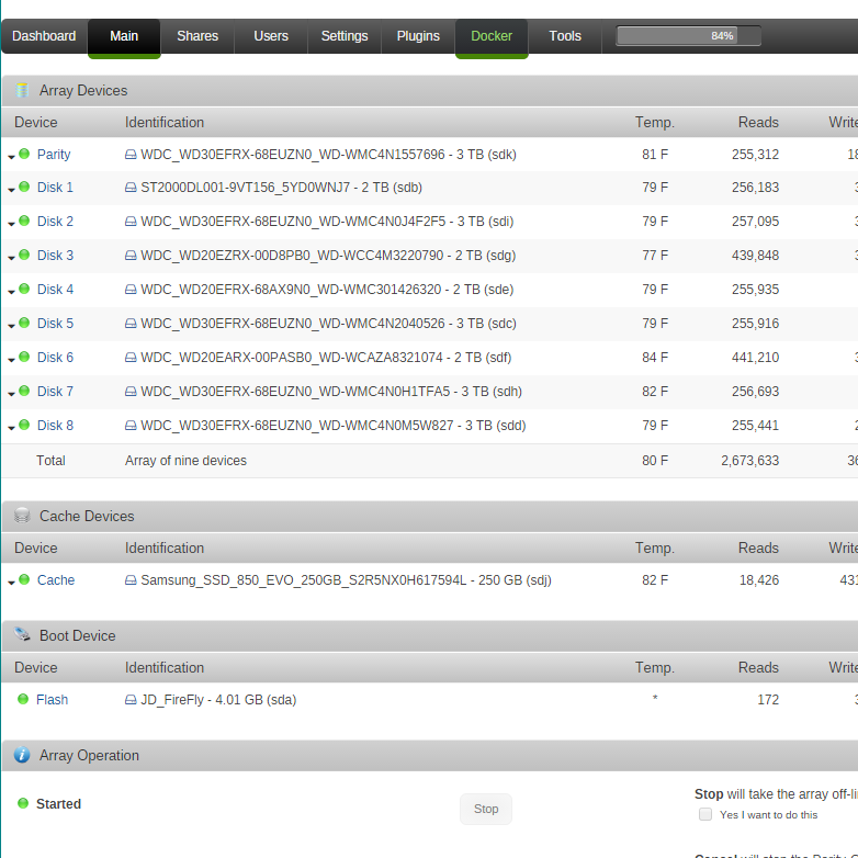

Before I go digging into my setup, I was hoping to get a sanity check on my Unraid Server.
Things starting acting a bit odd.  Media wouldn't stream properly, various Kodi instances would act up, so went digging into my syslog (attached).
Found a bunch of errors related to ata8, which I *think* is sdh, which means the errors are related to Disk 7 in my array.  Correct?
If so, I'm going to go in and check the power and sata cable.  But....just don't want to go screwing with the cables of a drive that's working well.
Thanks!

You can see while ataX relates to which drive by clicking the little picture of the harddrive next to the drive's SN
Perfect. Thanks so much for the pointer!  Would have been totally barking up the wrong tree!
