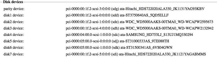

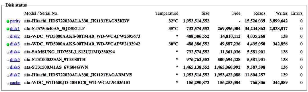

While I was asleep last night it appears that one of my disks (sdj) a Seagate, decided to not play nice and try to reset itself (which it did) but in the process caused some weirdness.  I have u-notify installed and it is reporting that the Seagate drive is not "there." But when I check through unMenu MyMain, unMenu Main, and the unRAID WebGUI everything looks fine.  Everything has a green ball beside it and it looks to be happy.  The drive letter does look like it got reset to sdl, but I am not sure if that caused a problem or not.  unMenu does appear to be trying to look for sdj and get a temp for the drive.  Perhaps some smarts needs to be added so that if a drive does get rearranged for whatever reason it does not keep looking in the same spot?

Below are the pics and syslog.

I've seen this several times, and it is always hard to diagnose definitively.  The disabling of a drive by the low level kernel module always seems to be fatal, and what makes it worse is that unRAID is not directly informed of the loss of the drive.  At 04:08:10 of this syslog piece, the first exception occurs, and only 14 seconds later the drive is disabled.  Hard resets were tried and at first the SATA link was working, at full speed, but full communications are not successful.  Then even the SATA link goes down, and it gives up on the drive and marks it disabled.  The drive is still there, and sporadically responds partially, but it take over 35 minutes before it is even able to identify the drive.  Probably because sdj is still in use (by unRAID associating it with Disk 5), it assigns a new device ID sdl, but this is useless from unRAID's point of view, because unRAID is completely unaware of this assignment.  Even if the drive was able to be completely mounted, unRAID would not know about it, and would continue trying to contact sdj.  Any attempt at that point to use Disk 5 would have then resulted in apparent drive errors for it and a red ball.
