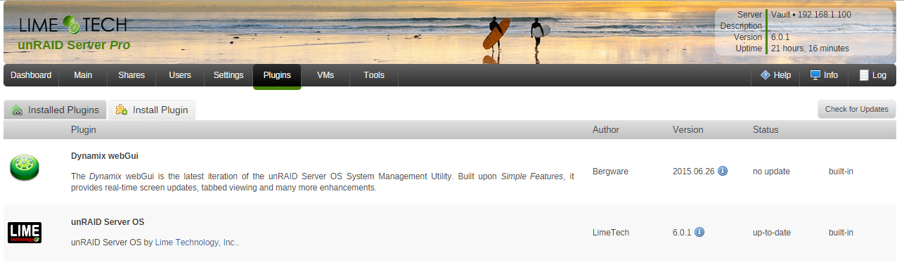

* The general recommendation for upgrading is to go to the plugins page and hit check for updates. When I did this no updates were found and it simply said that the unraid server os was "up-to-date" (see attached screenshot)
