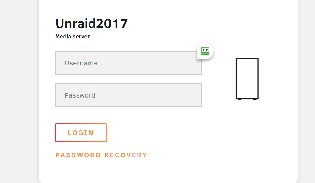

November 30, 20223 yr Backed up my flash files and just recently cannot login to root tried my backed files 6.9.2 and 6.11.5 then reformated flash and copy prokey and deleted the 3 files. Reboot server and it prompts for new pw it accepts and then try to login and put in new root pw and no response and no error message just blank Use roboform to save my pw's. Can someone suggest what I should do? worked on this for 1 solid hour and got no where need some help

November 30, 20223 yr Followed those steps from your link tried both methods listed in link. It prompts for new root pw and accepts new pw. Then I type it in and get the result where no error message and just a blank login screen like I showed above. Still not working
November 30, 20223 yr Community Expert Try a different browser, also make there are no Ad-blocker or firewalls blocking GUI access.
