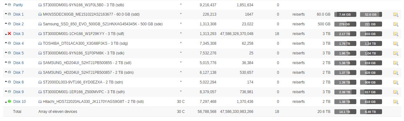

I was copying files off of Disk 10 on my server to start the process of updating the drive format.  I glanced at the unRaid main page and found Drive 3 was disabled with a rediculous number of drive writes.  See below image.
I couldn't get a smart report and the drive wouldn't spin up.  So I stopped the array and found the drive was not even showing up in the dropdown as being attached.  OK probably a loose cable.
I shut down opened the case.  the cables for drives 1 and 2 felt loose (they dont latch) but everything else felt solid so back together and i restarted.
Drive 3 still showing "Disabled" status, but this time I was able to get a short smart test run  (attached).  Nothing caught my eye.
The drive looks good but I can't seem to get it to "enable" wit the array started.  So here is where I probably screwed up.  I unassigned the drive and started the array, not thinking after stopping the array, it now sees it as a new drive, but it is showing up fine.
With the array started I can access the drive (emulated) and played a couple files which doesnt really tell me much.  I have no idea what all those writes were from or what triggered them.  I'm in the middle of an extended self test on the drive and will post the results here shortly.
Should I just re-assign the drive and see if it will re-build?  Is there any way to recover the old configuration or would you not trust the data on it to run a parity check?
Thoughts on the best way forward?  FYI, if i lost data, this is the one drive in the box I would not loose sleep over.

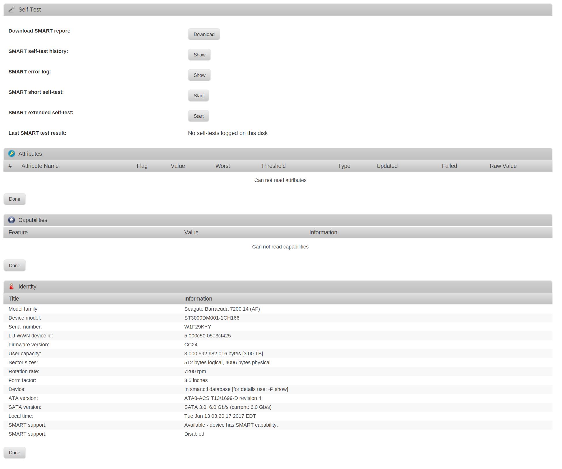

So the preclear completed successfully.   However, I still can't seem to get a smart report.  When I go to the drive page, I can't get any action from clicking on the button to start a short test.
Any help?
This is all i can get:

This is the only screen I know how to get a Smart report on.  Note at the bottom is says "Smart disabled"... how do you turn that back on?

Telnet into your server or log into console if you have a screen attached.
Then type smartctl -s on /dev/your_drives_mount_point
For more options type smartctl -h or see here.
Like Fireball posted you just need to enable SMART, some disks come with SMART disable, unRAID enables it when the disk is part of the array, but not for unassigned disks.
The command that finally worked:
smartctl --smart=on /dev/sdd
-s was invalid (possibly a new version?)
