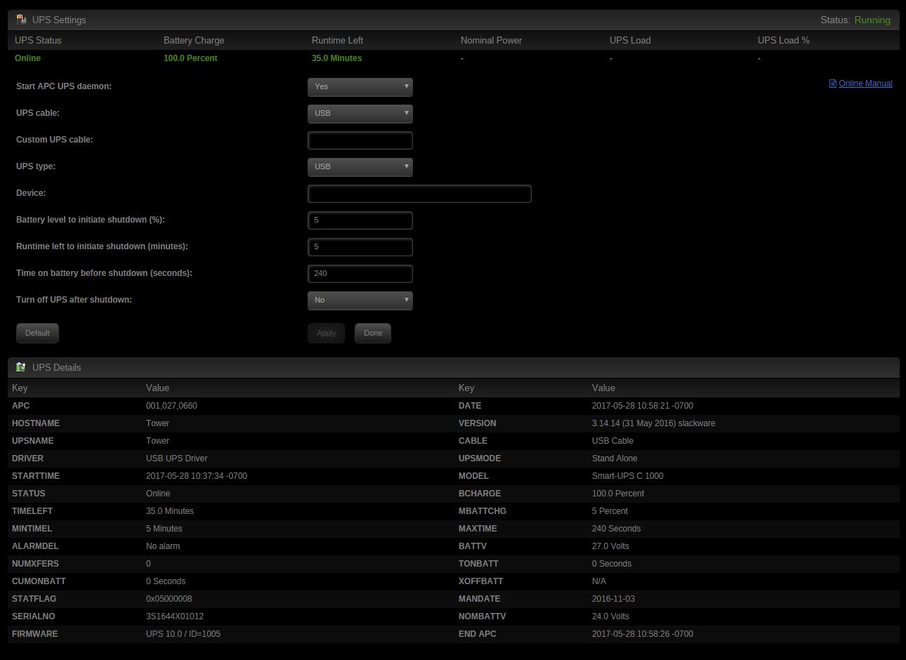

My old APC Backups UPS died so I went out and purchased a APC SMC1000 Smart UPS.  Unraid says it cannot communicate with it.  I've tried changing the cable type to USB, SMART, and one other option - to no avail.  I also played with the UPS type, Simple, etc, none of them work.
Can anyone confirm this APC SMC1000 will work with unraid and apcupsd?  If yes, what settings should I use?
What settings are you using for :
UPS Cable
UPS Type
Ok, I got to working, sort of.  I had to put the USB cable to USB and I had to put USB Type as USB, even though I have a SmartUps.
The good thing is I have basic UPS support now for emergency shutdowns, but the UPS status only shows how much the battery is charged and expected run time.  The other information is missing, like Load.  With a Smartup UPS, I should have all of the information.
I tried all other settings for both cable type and UPS type, and all fail and will not even work, except the above mentioned settings.
Any idea why unraid cannot talk to this Smartups?  Why would we have a APCSMART option if it doesn't work?
On the back of this UPS, there also a DATA cable (RJ45 style to USB - which APC has used for years).  So i have both USB and this DATA port.  Because it came with the USB cable, that is what I connected.  I think I could dig up a APC data cable - should I try that and use that port instead of the USB port?
On the UPS settings, on the right side near the top (just under the status line, you will see a link to the online manual for apcupsd manual.  I would suggest that you go the 'Bible' and see if you can find the answers to your questions.  There is a whole section on Configuration settings.   Or you could try the APC forums (I assume that they have one) and see if someone there has an answer.

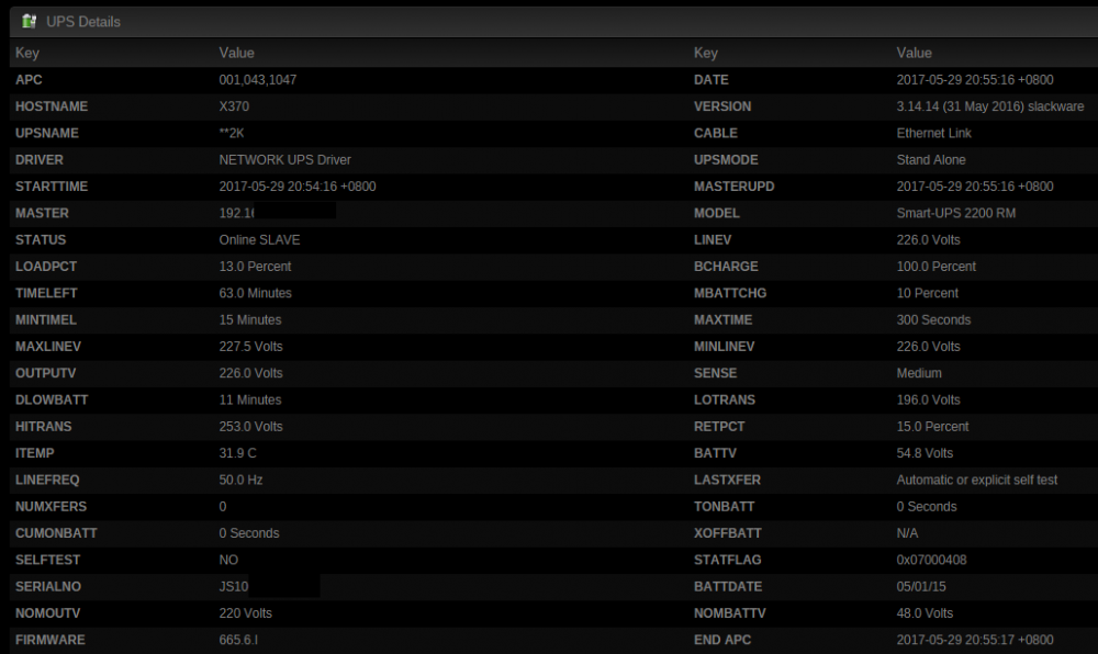

Please see my post on getting the APC SMC 1500 UPS working....

I think APC SMART ups not mean all item will be same/exist, my one will show "Load%" but no "Load" item, this same under "PowerChute Business".
In unRAID most item could be show as below.
I also have 2 "Back ups", both also have different item show.
