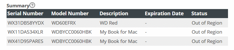

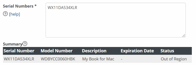

Not the first time this happens, you can confirm by entering the serial number on WD RMA page.
Well that’s annoying..  I’ll go ahead and replace the parity disk and then expand it afterwards.  thanks a lot
Of the three WD60 you have only serial WX31DB58YYDX should be used as parity.
