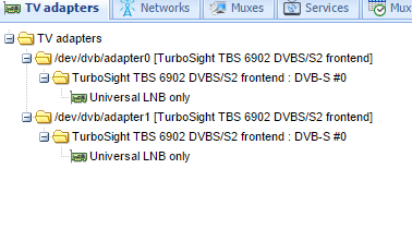

I installed the driver , but its not showing up in tvheadend ( restarted tvheadend )
( at github they mention that you need to remove sundtek driver from host and install in the guest.)

the sundtek adpter/driver is running on unraid,  the output of /opt/bin/mediaclient --lc
**** List of Media Clients ****
/dev/dvb/adapter2/frontend0:
  No client connected
/dev/dvb/adapter2/dvr0:
  No client connected
/dev/dvb/adapter2/demux0:
  No client connected
/dev/video0:
  No client connected
/dev/vbi0:
  No client connected
/dev/radio0:
  No client connected
/dev/rds0:
  No client connected
/dev/mediainput0:
  No client connected
/dev/dsp0:
  No client connected
If i remove the usb adpter the output is
Informatie about the driver and /opt/bin/mediaclient  found on
http://support.sundtek.com/index.php/topic,4.0.html
(adapter 0,1 is a TBS6902 )
The if you use my tvheadend DVB tuners container, you should have the dvb-t stick available in tvheadend.
The dvb-c stick adapter is not visable  :(

Hi saarg i did reset tvheadend after driver is installed , but the tvheadend does not recognize adapter 2 ( i use dvbc and not dvbt /opt/bin/mediaclient --setdtvmode=DVBC )
log tvheadend :
Aug 29 20:51:34 NAS01 tvheadend[18]: linuxdvb: adapter added /dev/dvb/adapter1
Aug 29 20:51:34 NAS01 tvheadend[18]: linuxdvb: adapter added /dev/dvb/adapter0
log tvheadend :
