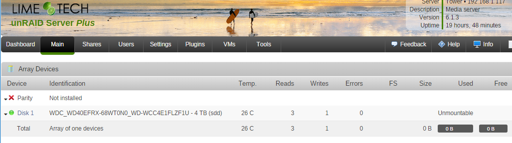

August 30, 201610 yr Author When the rebuild finishes you can unassign the parity disk (or maybe you need to disconnect it from the server) and start the array with the data disk only, see if it mounts. Rebuild finished. I stopped the array, unassigned parity, started, and disk1 still doesn't mount. Screenshot attached. Going to try a new config. Edit: now I'm more concerned. New config, checked "parity is already valid," started the array, disk1 still didn't mount but unraid began a parity check with "write corrections to parity disk." I stopped the check after a few seconds. Just can't figure out if this is hardware related or not.
