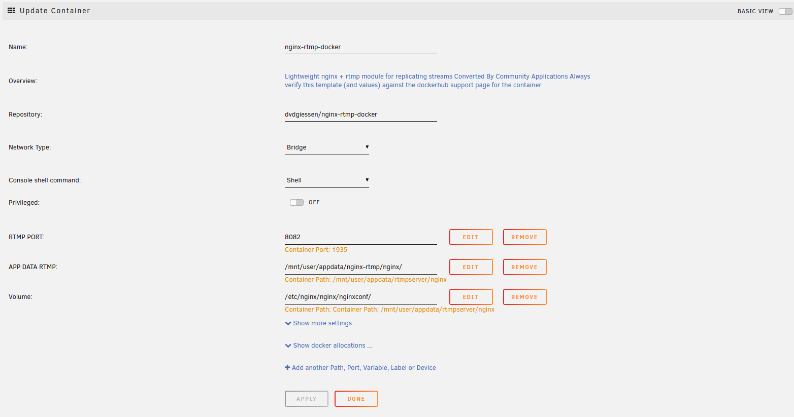

it would seem this is not as easy as one would think - Just to introduce myself, I am currently trying the same task above, I am by no means a Linux guru nor amazingly tech savvy, however I can follow good instructions haven built my own server and compiled the Unraid server, mounting and running various dockers just following YouTube Vids and forums a like.
I would really like more clarity on this, from my limited understanding, I managed to configure the folders in the editable setup of the rtmp-nginx docker with the assigned port 1935, also creating the nginx.conf file with the above lines of code. docker setup below
the setting I have above is an attempt not really knowing if this correct.  after applying the settings the docker compiled successfully,  however when I checked the log output its was blank?
needless to say, I tried to gain further conformation via the VLC program using my localhost IP and port prefix 1935 with no great surprise, this proved unsuccessful.
After several attempts I was hoping that someone with greater knowledge would have the correct sample of the settings in the docker setup so I can cross reference the errors of my ways, forgive my ignorance.
Any help would be appreciated :-)

If you go like that you have to place the config file in the "passedthrough" conf folder. Then it should work. Just copy the conf file from github and paste it in your folder destination.
the next thing is. In your Docker Edit you just mapped the wrong container volume/folders. The Container Path mostly does not match with the path you set for docker. E.g. Docker Path is /etc/nginx/ --> (mapped to) usr/mnt/appdata/rmtp/conf or so on
I hope this is understandable.
