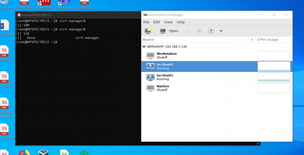

I use virt-manager with spice VMs. I don't have my notes in front of me but I believe I used space invader one's youtube tutorial on virt-manager setup and then did similar to use to modify the VM to use spice display. AFAIK virt-manager is not available for Windows however.
  • 8 months later...

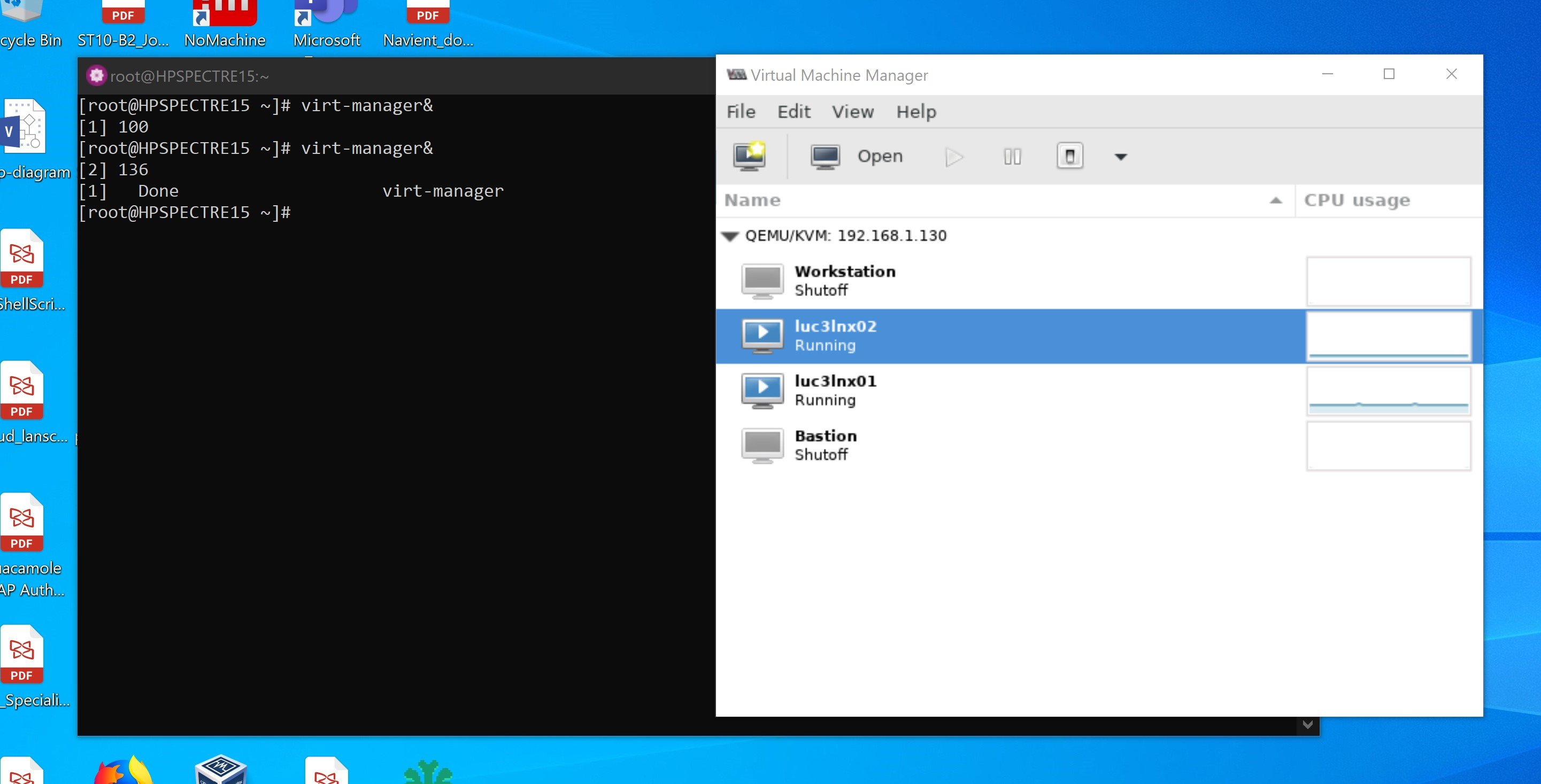

resurrecting this old thread just to say you can install virt-manager fairly easily on windows thanks to Windows Subsystem Linux (WSL).  You'll merely need to enable WSL then install your favorite distro in WSL, then install virt-manager on that distro.  Finally you'll need to install an X window manager like Xming on your windows machine.

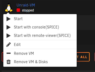

So it looks like it Spice IS an option now. I can't seem to get copy paste working with a Windows 11 VM. Are there add-ons that need to be installed for Unraid as you would on the client itself?  (See Windows installers here--> https://www.spice-space.org/download.html)

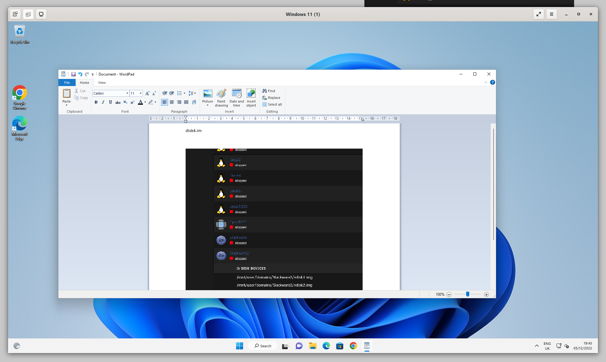

Does seem to do graphics also. I snipped this on my desktop

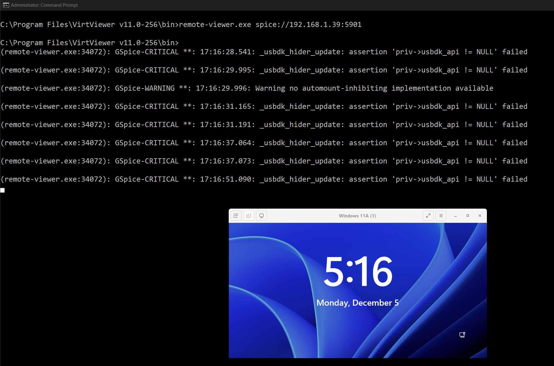

C:\Program Files\VirtViewer v11.0-256\bin>start remote-viewer.exe spice://192.168.1.10:5901
 App starts, but holds open the window with status updates.  I guess it doesn't matter until I can get the clipboard to work, but something to look at if anyone cares. It is definitely better than VNC from my experience.  Is there another viewer option for Spice?
Edit- its working now! Yea!!!!!

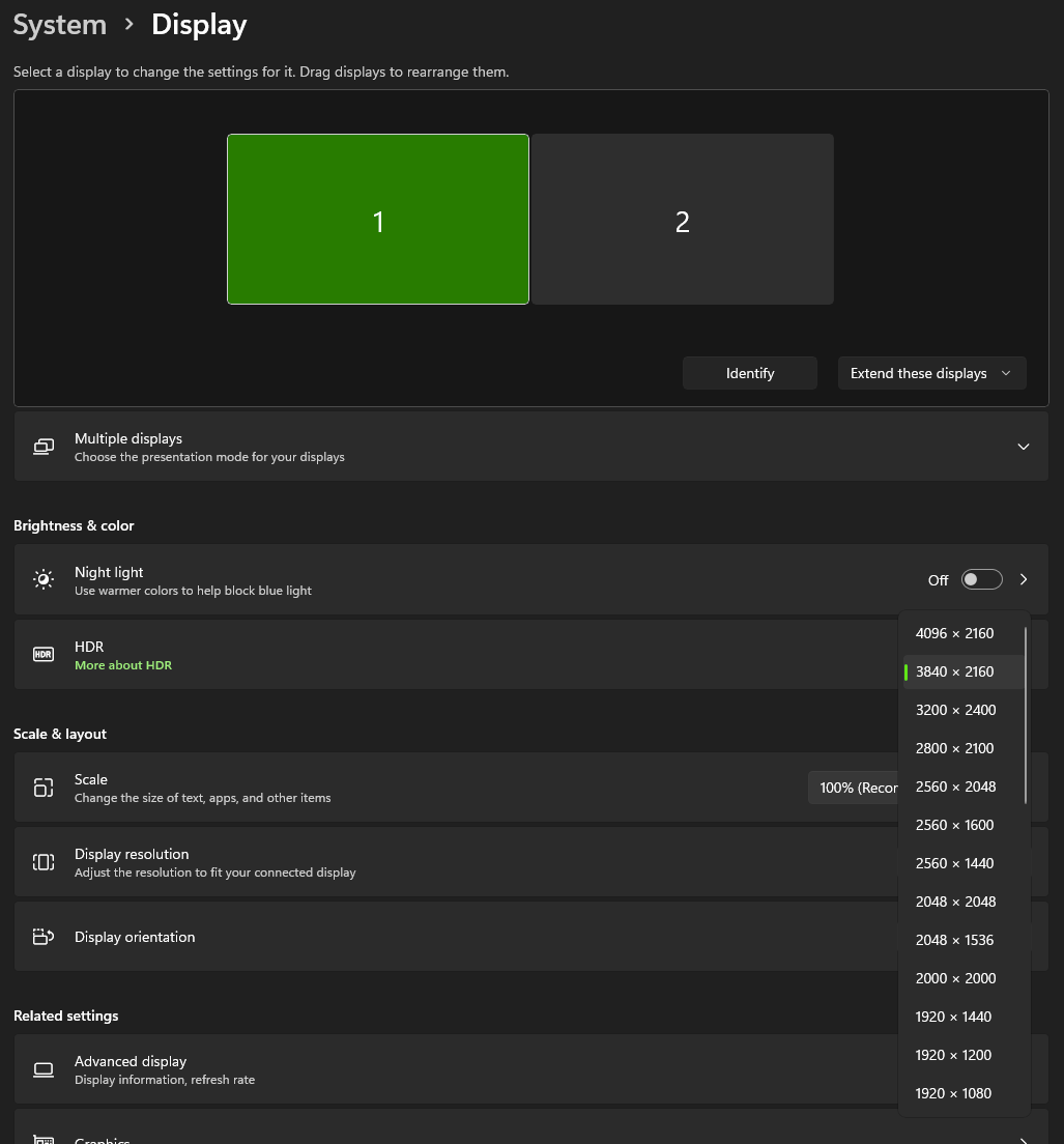

Is it possible to get 4k resolution using Spice? (3840x2160)
Edit- yes!!
Edit the XML of your VM and change the video section for your virtual display device. Change vgamem from 16384 to:
vgamem='65536'
Example:
    <video>
      <model type='qxl' ram='131072' vram='65536' vgamem='65536' heads='1' primary='yes'/>
      <alias name='video0'/>
    </video>
