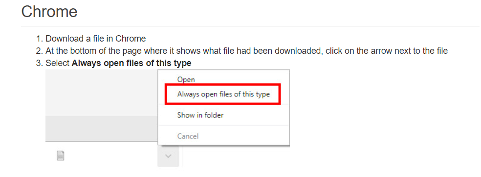

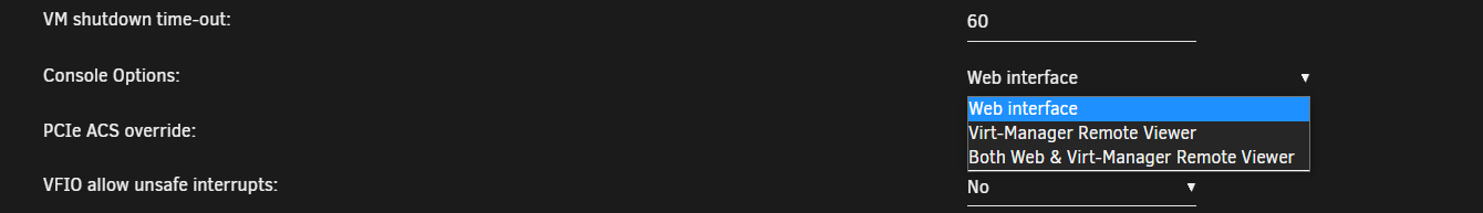

On 4/21/2023 at 7:47 PM, SimonF said:
Added support via PR1307(subject to being merged) to start remote viewer from the unraid console. Support both VNC and SPICE
This is in 6.12rc4 you can specify which options are shown in vm settings web remote-viewer or both
You need to set browser to always open the file type .vv after first download

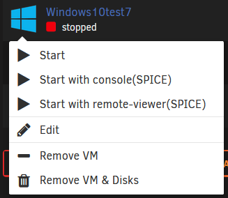

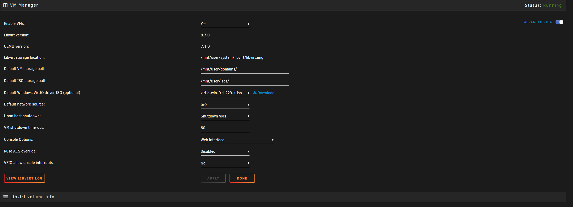

I'm on 6.12.3 but cannot see this option to launch remote-viewer - where are they located?
Edited by Econaut
Do you have advance view toggled?
Then either from vm or dashboard you should see.
I did not! That was it, thanks
