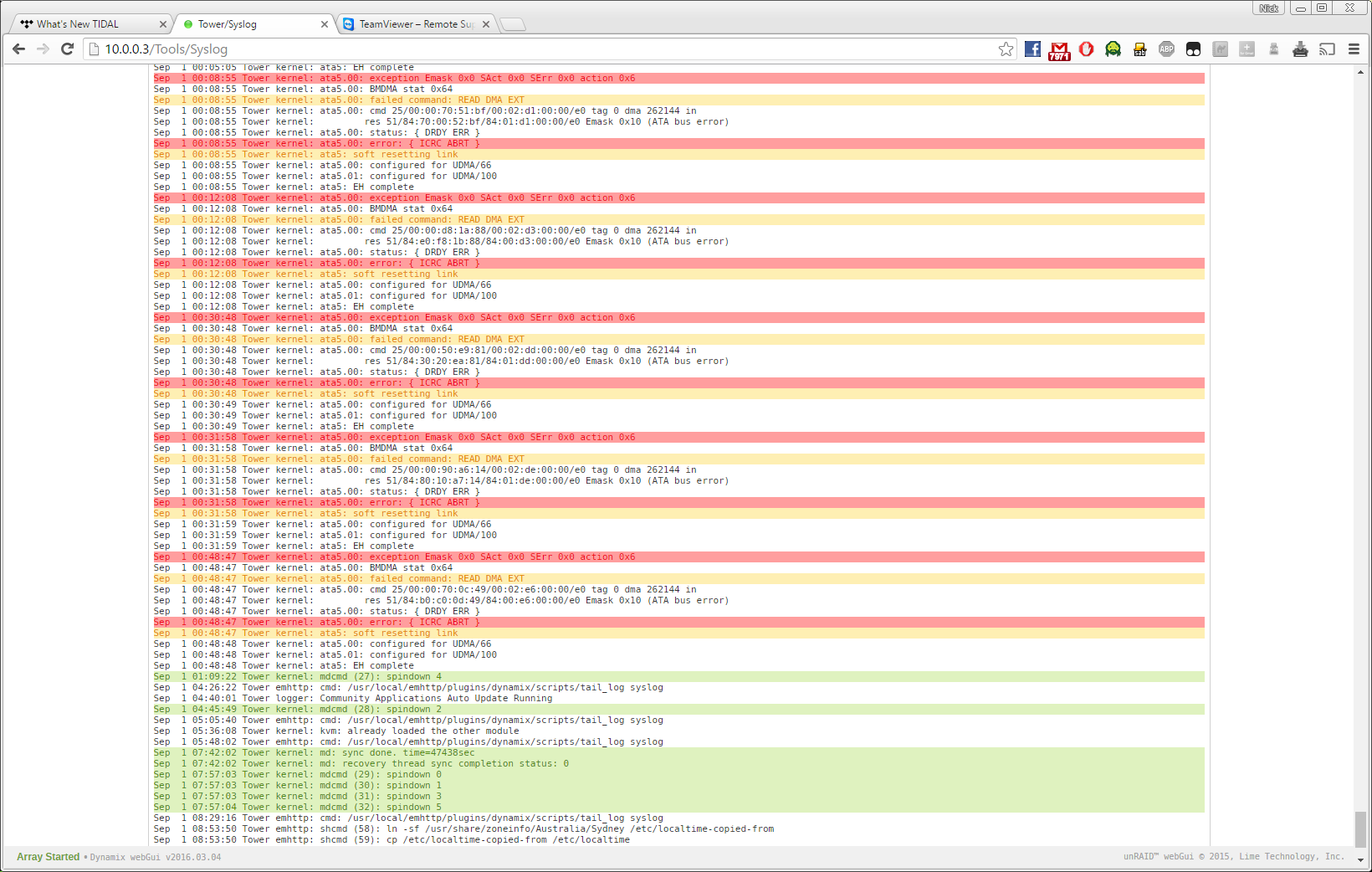

I see a lot of red lines in my latest log and believe my disk2 needs to be rebuilt. I'm concerned it might be more than that and don't want to start a rebuild only to find a gremlin means my array is not protected.

SMART report on disk 2 shows it passes but subject to old age/prefail, but logs show a lot of disk 2 read errors, as well as other errors I don't understand.  I'm RMA'ing the failed WD Red today, so can rebuild disk 2 after work if that is the real problem.
As mentioned I believe from my reading of the logs disk 2 should be rebuilt, but if it is more than that I won't like to put the array at risk.

SMART for disk2 and other drives OK. Most likely a bad connection.
@trurl, many thanks, ill double check tonight.  When I see this much red in my syslog (picture attached) I get a bit concerned.
Better check and double check or replace cables.
