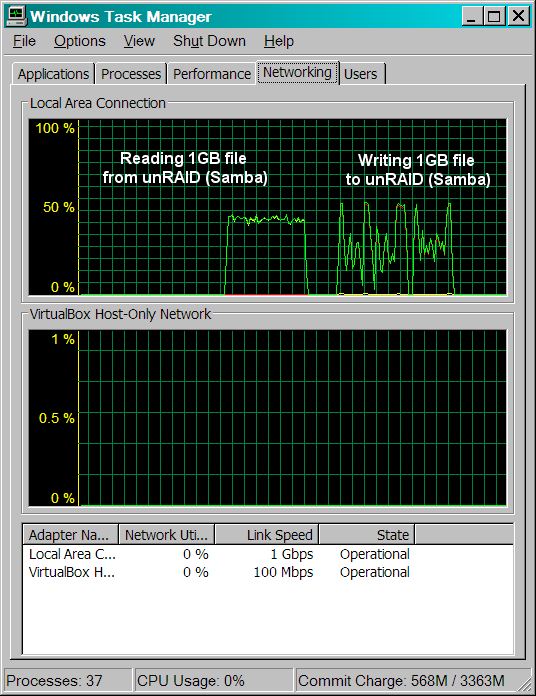

And the "spikiness" when writing was apparent... see this image:
I tried manipulating the unRAID tunables, as well as the disk scheduler, and could while I could get worse results, no combination gave more than about 5% better performance, and those were not always consistently better.
I just made a special kernel build of kernel 2.6.32.7 with unRAID 4.5.1, in order to try the new flushing system introduced in the 2.6.32 kernel, doing away with pdflush.
Wow.
All the "spikiness" when writing to the array over the LAN is gone.
Compare this graph:
to the old one using the exact same system, but with the older kernel:
index.php?action=dlattach;topic=5146.0;attach=2418;image
Write speeds were 20% faster too.
Wow...  way less need for a cache drive now. ;)  Just as well I never bothered to add one.  ;D
