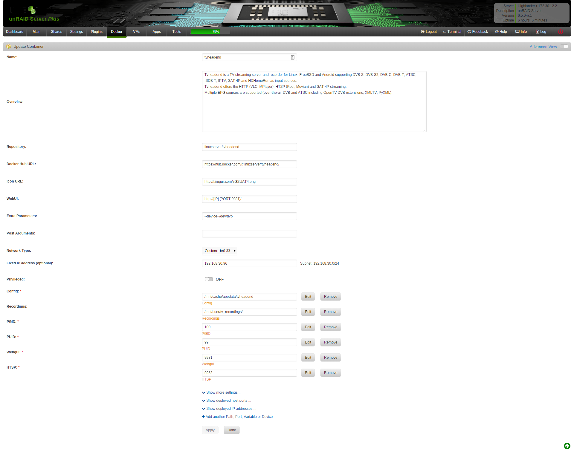

me again..I upgraded to 6.5.0rc1 last night and my cards aren't showing in tvh.  Double-checked with @CHBMB that the drivers have loaded and also by temporarily installing the dvblink docker where the cards were working.  Also tried deleting the image and installing a 2nd temp instance - still no joy
Anybody else having recent problems?
highlander-diagnostics-20180302-1027.zip
You again... :D
Can you give me the docker run command?
6 minutes ago, saarg said:
You again... :D
sorry, as you know I'm not technical so not sure how to do that but here are my docker settings.
It was all working fine (apart from iffy kodi recordings which seem to have been resolved in the latest kodi builds - tried mkv (didn't like not being able to watch while in progress) and went back to pass and all ok) although I did notice this morning when I went to check there was a 2nd empty non-mandatory 'Recordings' field had been created - I just deleted it as I had my own, and I don't think this is the problem as I did a fresh install and the tuners weren't appearing there either5a995062cdb7e_FireShotCapture60-Highlander_UpdateContainer_-https___1d087a25aac48109ee9a15217a.thumb.png.1a6949b2eac8a44a7af48d9c0899969d.png
ok, I've tried rebooting and completely removing everything including my appdata and doing a fresh install, and still no tv cards appearing.  Double-checked again by installing dvblink and the cards are appearing there.
Going to post in the Rc1 forum as I think that's the problem as nothing else has changed in the last 24 hours except that upgrade.

@DZMM Have been away for work the whole week and haven't had time to answer, but I agree with @CHBMB that it has nothing to do with unraid. Try using the release-4.2 branch as the latest tag gives you the development branch with heavy development at this time. Stuff will break.
Could you give me the output of the below commands.
ls -la /dev/dvb
docker exec -it tvheadend ls -la /dev/dvb
ls -la /dev/dvb
Ahh, I didn't release that 'latest' meant 'unstable' in tvheadend's world - might be worth changing the text in the docker from latest to unstable:
Build Type Description Version Repo Component
release The latest version marked for release 4.2.5 release-4.2
stable The latest stable code with changes/fixes between releases 4.2.5-x~githash stable-4.2
unstable This is the current development "bleeding-edge" 4.3.x unstable
I was wondering why no-one else was piping up with problems.  I just tried moving to linuxserver/tvheadend:release-4.2, but I'm getting an error that's stopping it starting:
 [ ERROR] caclient: wrong class caclient_dvbcam!
A quick google said this is something to do with using a 4.3 config in 4.2 - once I've worked out how to fix I'll have another go, but I'm guessing that given I'm the only one with problems it means the 4.3 builds don't work with 6.5.0rc1.
To be honest I've always been on unstable and this is the first time it's not worked, so it could be something to keep an eye on.
Will report back
Latest means latest, 4.2 isn't latest, but stable. The latest tag have been the development branch from the release of this container.
You should use a fresh appdata when going back to a previous version as there are a lot of changes in the development.
Edited by saarg
Latest means latest 4.2 isn't latest, but stable. The latest tag have been the development branch from the release of this container.
When I installed my docker I chose 'Default' which is described as 'Install Using The Template's Default Tag :latest'.  I went with default as it seemed safer.
From what you've said, this should be 4.2.x but I've got 4.3.x - so something's not right in the description.
I'll do a fresh install now using 'release-4.2' not 'Default'
