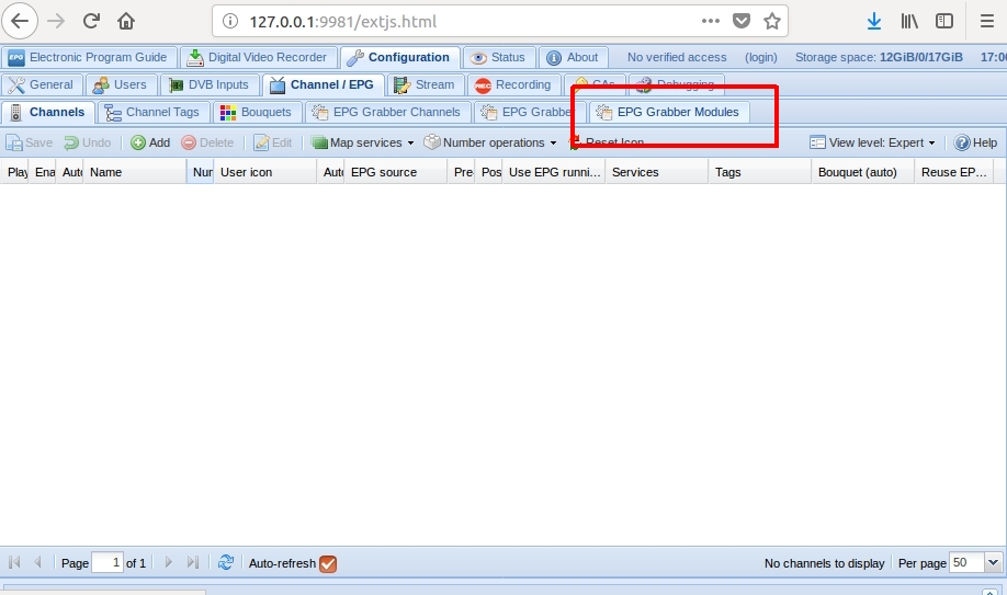

When I run TVHeadend on Linux, I see "EPG Grabber Modules" - see attached screenshot.
Can I confirm I should be seeing this in the docker? Thanks!!

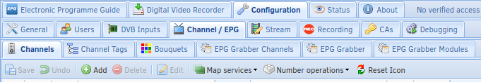

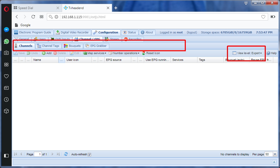

Configuration: General: Base: Default View Level: Expert
I have tried clearing cache and even installed FireFox and Opera (from scratch) but still do not see that tab....
Not an emergency by any stretch of the imagination.... :-)
Change the View level in the General tab, and you will see the light...
That's what I told @TexasDave to do.....
I know, but looks like he didn't see that...
I'm thinking he might not run our container if he set it in the general tab.

@CHBMB - Thanks! I hope all is well for you? Been awhile....
@saarg - Many thanks as well.
Both - I have "seen the light" and it is now sorted. I misunderstood what you were trying to say. A bit slower as I get older...Thanks again!
32 minutes ago, DZMM said:
something makes the option appear though as it wasn't there initially for me either
That would have been the view level.

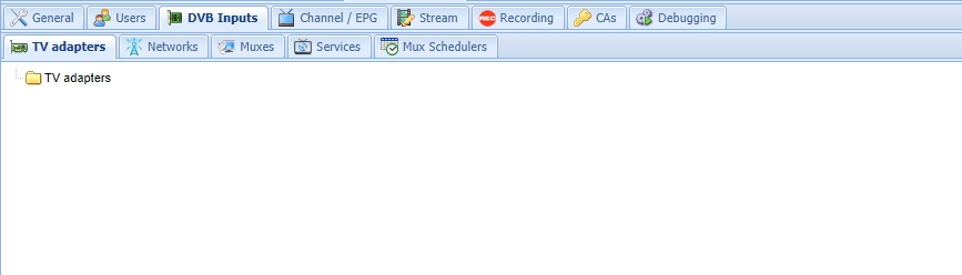

they are not appearing in the interface - same problem I had with RC1 when I was on 4.3.x,  so I rolled back to 4.2.5x based on the feedback and still no tuners after going to rc5
Edited by DZMM
Just now, DZMM said:
screenshot.4.jpg.02e7bb1f761847ec5e964189fb2d8774.jpgthey are not appearing in the interface - same problem I had with RC1 when I was on 4.3.x,  so I rolled back to 4.2.5x based on the feedback and still no tuners after going to rc5
PM sent
So you haven't seen my post in the DVB plugin thread?
Do a chmod -R 777 /dev/dvb and the tuners should show. Put it in your go file so it gets applied at every boot.
