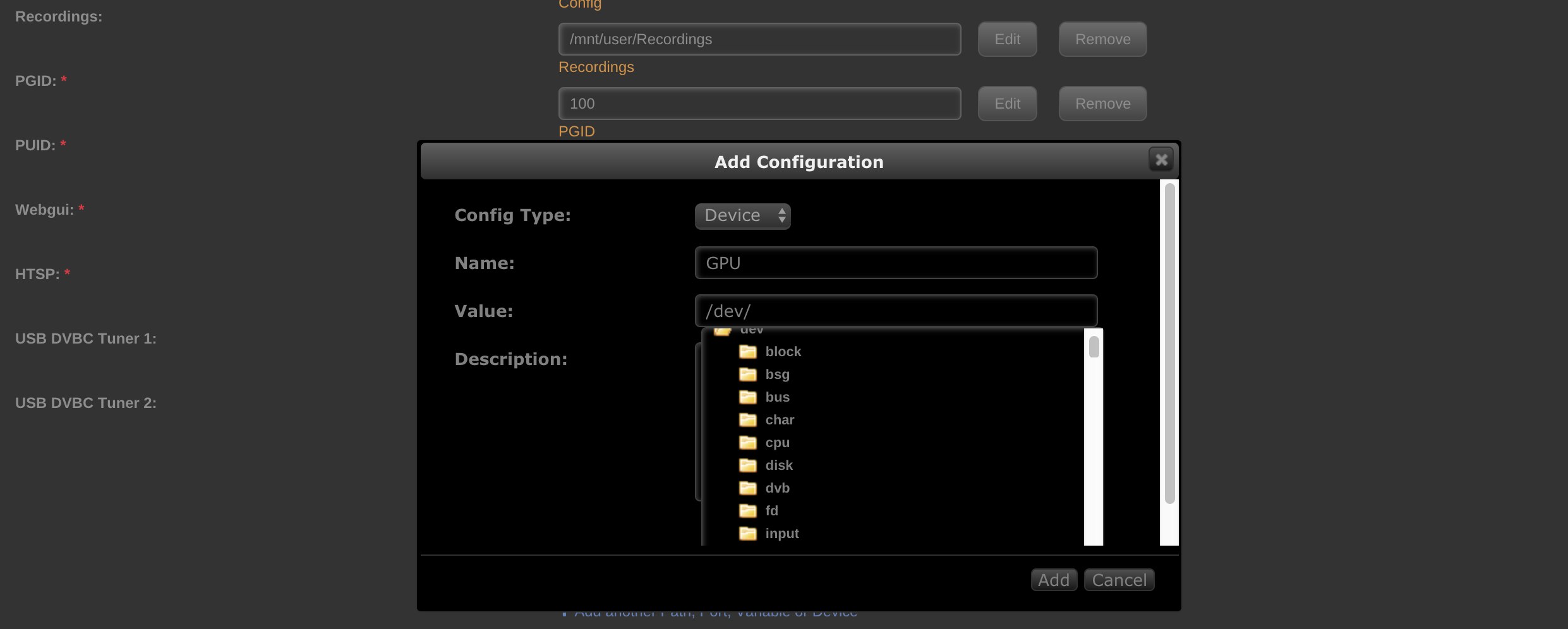

Can anyone point me in the right direction in regards to passing through my GPU please? I have a GTX 1050 I'd like to use for x265 transcoding, however I don't seem to have /dev/dri when I try to add a container device.
What am I doing wrong?
Thanks

You're not doing anything wrong. The only GPU supported on unraid is igpu in Intel processors.

Ah I see, so I guess my straightforward option from here on in is VM?
Cheers for the quick response, I thought I was going mad!!
I don't know how good the nvenc support is in tvheadend though. Might not work so well, but check the tvheadend site.
