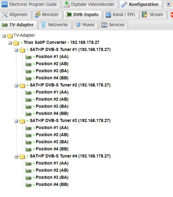

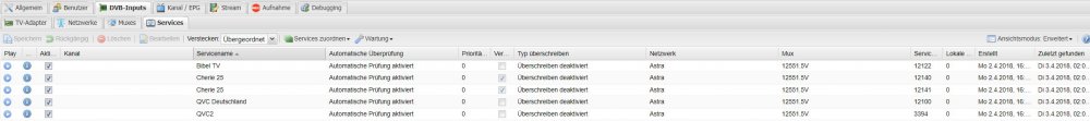

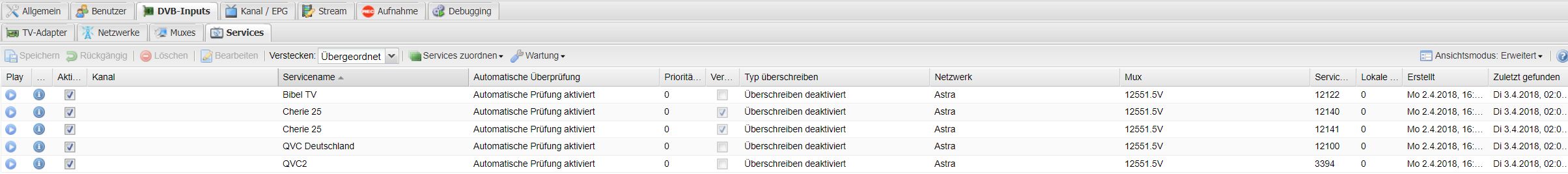

Not so sure whether my inquiry is a docker or a tvheadend issue..... maybe somebody can help......
I am using a Triax TSS400 4channel sat-ip-streamer and tvheadend over docker......
I installed/ran tv headed via:
docker run -d --name="tvheadend" --net="host" -e TZ="Europe/Berlin" -e "PGID"="1000" -e "PUID"="1000" -v "/datastorage/tvheadend/config":"/config":rw -v "/datastorage/recordings/":"/recordings":rw -v "/datastorage/tvheadend/logos":"/logos":rw linuxserver/tvheadend
after tvheadend runs it's configuration, it looks like it did recognize my TSS400, but only 6! services on one MUX..... see attached screenshots.
I tried to redo the Assistant, tried to define my own Network, MUX, ... no success!

Most likely a configuration error, but I can't help you with satip I'm afraid.
I see you have mounted your own logos. We do supply picons with the image in case you didn't know.

Hi all,
it wasn't a configuration issue. I managed to get a full scan and asignment of services by adding one real one (out of my local SAT bouquet) manually and than starting the scan....
Got this approach from some TSS400+TVHeadend forum entries..... So just wanted to share here.
