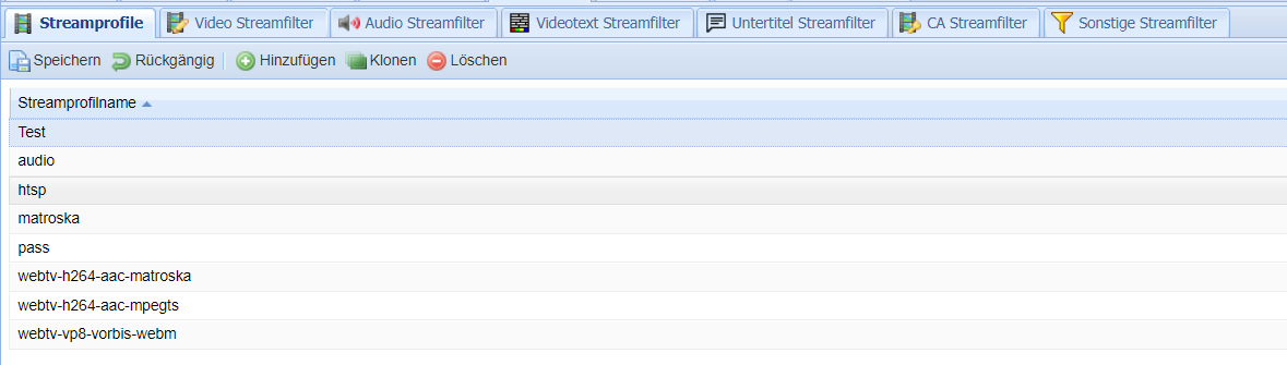

Hi, just a nice ask if u had time to test if its working ? device dri ... HW acc
No.

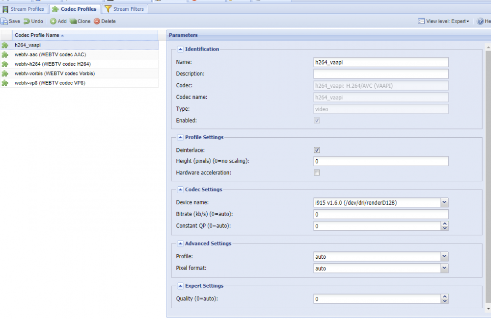

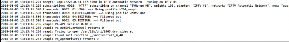

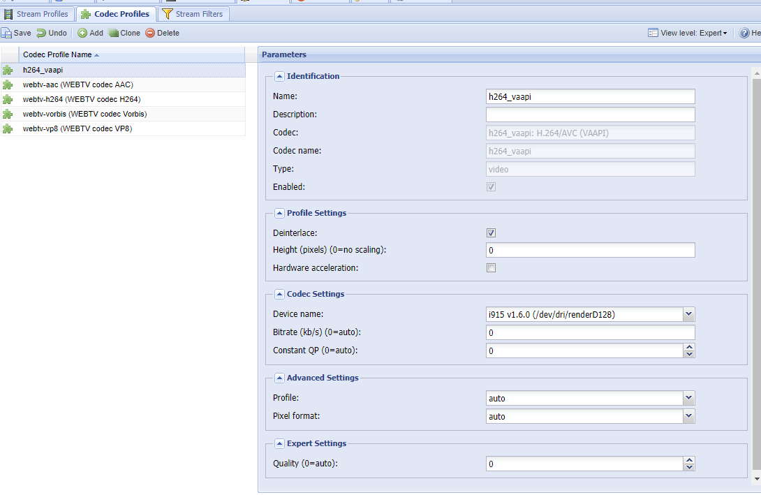

Did you create a vaapi profile in the codec profiles that uses /dev/dri? If not, you need to do this.
As you can see in one of my pictures, vaapi is working here.

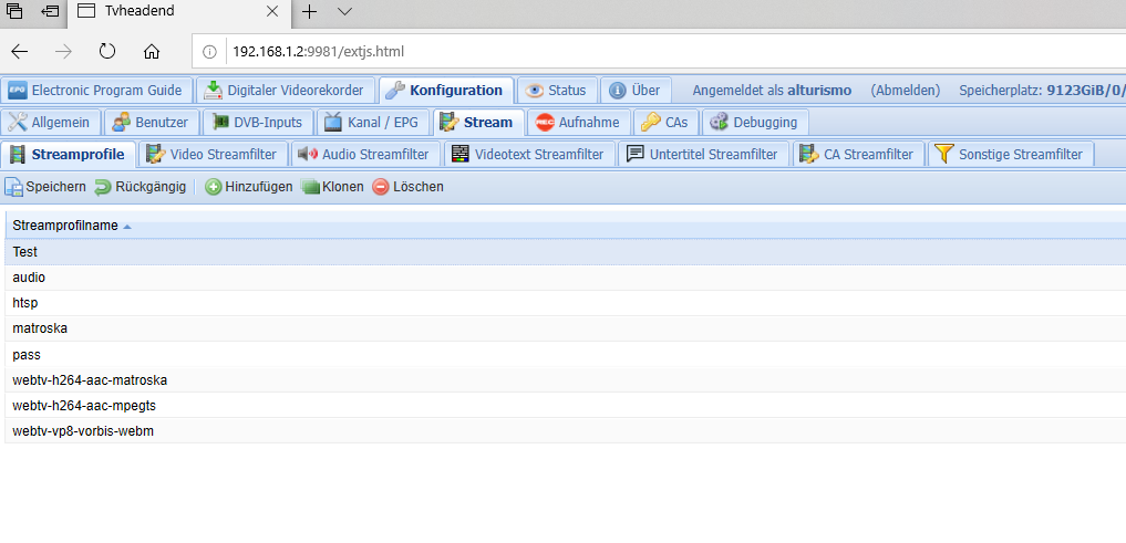

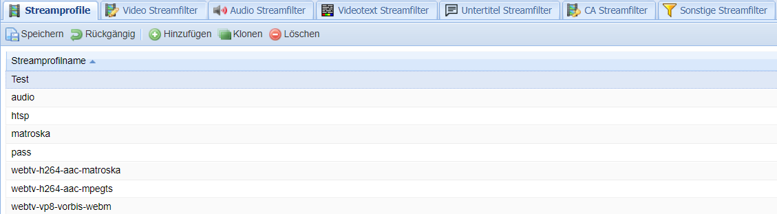

i see, nope, may cause i dont have this tab ...
im in Expert mode and i have these tabs for settings
No codec Profiles here ...

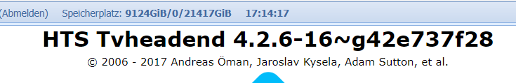

Are you running the stable branch? I think hardware transcoding is only available in the 4.3 version.
so, shell i change to 4.3 in Repo setting ? didnt knew its possible ...
If you only use linuxserver/tvheadend you will get the latest version, but that is a development branch and stuff might brake.
At least take a backup of your appdata before changing versions.

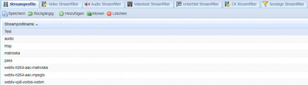

1 minute ago, alturismo said:
no option for "codec profiles"
Did you clear your browser cache?
yes, and tested now with another browser wich i never use
same result
same result
Post your docker run command.
