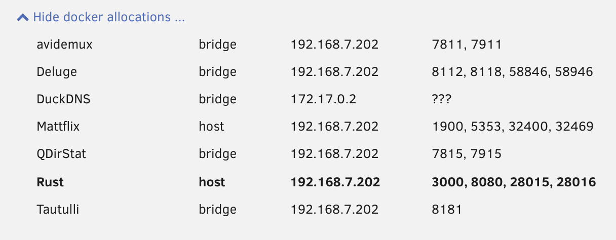

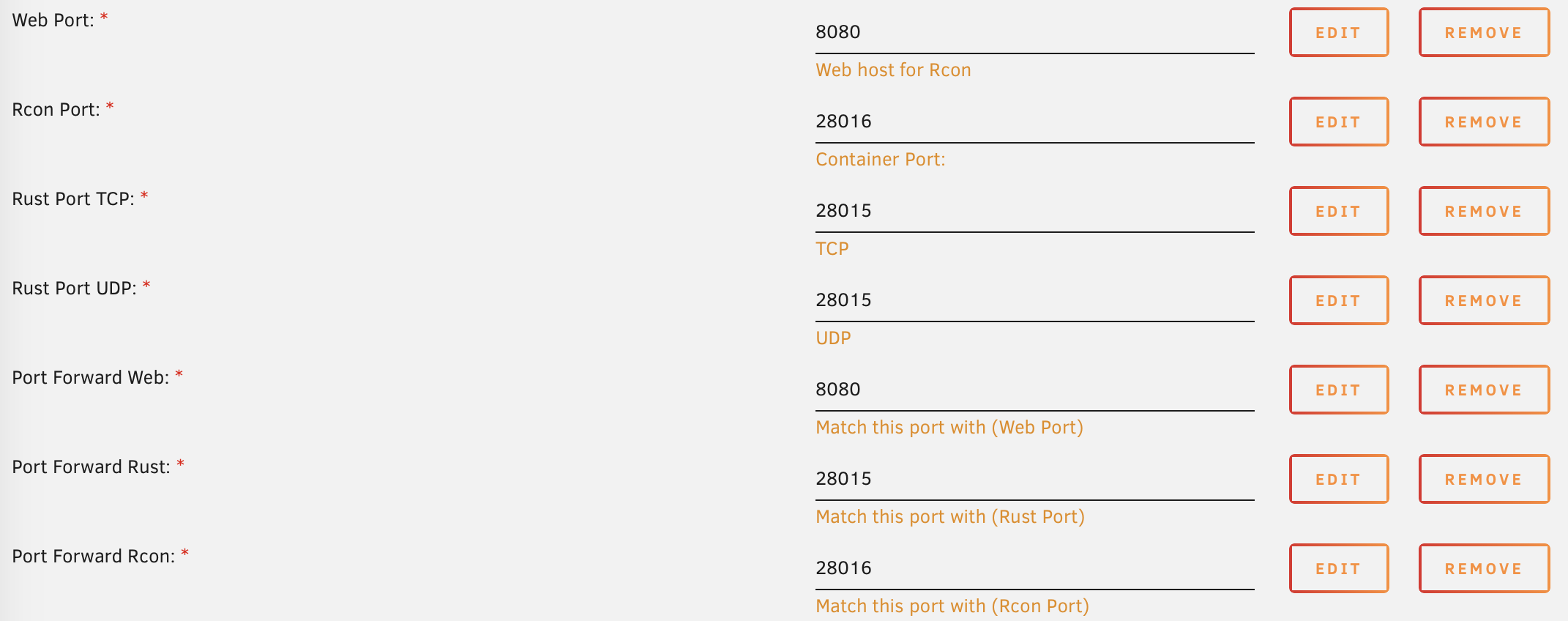

9 minutes ago, Mdarkness1988 said:
Hi. Thanks for letting me know.
From top of my head it looks like a port might be conflicting...
If this effect the server to start?
Please take a screenshot of the template settings and the drop-down that shows the other templates ports being used.
Thanks
Dude, holy crap thanks for the prompt response!

Screenshot of the rest of the config please and does it even startup?
