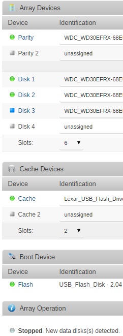

I stopped the array.
Selected the new drive to be disk 3. (All the drives are the same WD 3TB)
Disk 3 comes up as a new device (blue square), but then I can't start the array anymore.
I think I'm missing a step.
You should have a checkbox "yes, I'm sure" or something similar next to the start button, after checking it array will start and the new disk will be cleared.
As Squid said.
Your screenshot is clipped just perfectly to prevent us from seeing the relevant portion. ;D

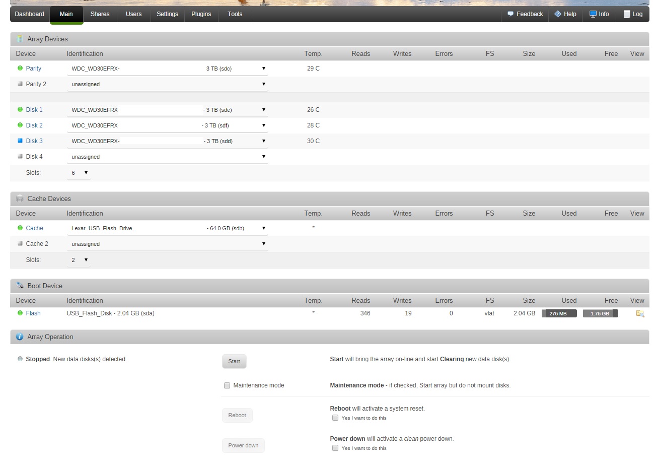

Sorry here is the whole page
(minus serial numbers)
i don't see the check box mentioned.
When I click start button, the page refreshes back to array stopped.
I don't know if there should be a checkbox. Since the Start button is already enabled I would guess not.
Post a diagnostic.
I remember there was an issue with one of the beta's not showing the checkbox.  it happened to me and I had to roll back to add a new disk.
It's a b21 bug, update to latest rc.
I believe there's no checkbox in this situation but you'll be able to start the array.
I upgraded from 6.2.0.rc3 to rc5
now it works, thanks everyone.
