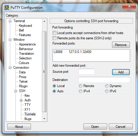

Eventually after lots of searching I found that I needed to open a ssh tunnel and connect to the server via that and then it all started to work.

Have you tried the ssh tunnel?
These were my settings
It worked!  :o

(On Mac Terminal) I tunneled my traffic:
ssh 192.1.1.100 -L 32400:localhost:32400
than at the Browser
http://localhost:32400
and the server is found!!! ;D
I closed the Tunnel and now it still worked as before, with the IP from the Tower and the Plex port. ;D ;D ;D
I don't know why, but now it works! ;)
