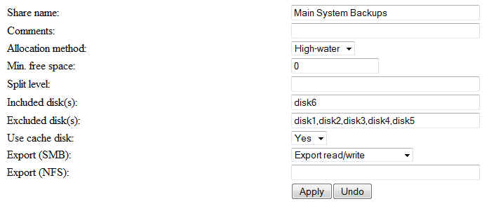

I did, I think, the screen shot is attached.
Is there another place to enable it?
But wait a second, I know it was enabled because I saw the file being created on the cache drive via the 'cache' share.

If you saw the file being created on the cache drive, it was enabled...
